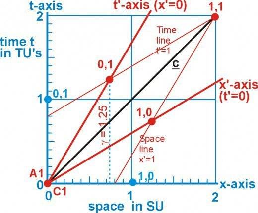

You appear to have made a mistake here. If the primed variables are measurements made in the moving frame, then it should be:
" Where t = γt', x = x'/γ " and not " Where t' = γt, x = x'/γ " as you stated.
The ct and ct' labels on the left graph should be reversed.
This means your next diagram is not technically correct:

because ct' should be less than ct, not greater.
I think you are trying to do something like this:
but not quite got it right.
I'm sorry but proper time, t = 0.8 seconds, which is dilated to coordinate time t' = 1 second. t = γt'
How can proper time be less than coordinate time?
Einsrtein gave us t = t' in chapter XII point (5) http://www.bartleby.com/173/12.html
That is exactly the way round they are in Figs 1, 2, 2a, 3

OK, I was assuming that the unprimed variables were coordinate values. In that case your diagram implies proper length x = 0.8 metres, transforms to coordinate length x' = 1 meter, which is length expansion, not length contraction. As far as I can tell the blue grid in diagram 5 is proper time versus coordinate distance and the red grid is coordinate time versus proper distance and neither grid shows the measurements of a single observer using his own stationary clocks and rulers.
For some reason you have the expression (t=γt') in the above quate agreeing with what I said and contradicting the (t'=γt) in diagram 3. Was that just a typo?

Easy. In fact you demonstrated it above. t=0.8 seconds, t'=1 second. Therefore t<t' and proper time is less than coordinate time.
