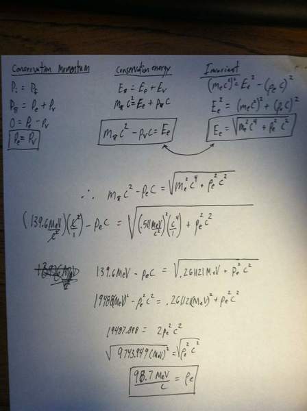

In summary: Okay so I took a break and came back to it, here goes round two :smile:The following image has my new work attached to it, but as far as that specific question is concerned, based on conservation of energy, Ee = m∏*c^2 - pe*c. From that I think I was able to solve for the correct answer, hopefully I didn't make a glaring mistake in the initial stepsYour steps are correct but there is a mistake in the final answer. You forgot to take the square root. The energy of the positron has to be positive, but you get a negative value without the square root. So the correct answer is Ee = 136.85 MeV

In the rare decay ∏+ → e+ + ve , what is the momentum of the positron (e+)? Assume the ∏+ decays from rest. (m+ = 139.6 MeV/c^2, mv ≈ 0, me = 0.511 MeV/c^2)
Conservation of Energy: E = Ee + Ev
Conservation of momentum: p = pe + pv
0 = pe + pv
pe = -pv
Invariant mass: E^2 = (pc)^2 + (mc^2)^2
My first step was to ensure momentum was conserved, stating that once the pion decayed, the positron and neutrino went off in opposite directions. This yields the equation pe = -pv.
Next I went about finding the rest energy of the pion, which following the equation, E = mc^2. Using this I found the rest energy of the pion to simply be 139.6 MeV.
After that I began to use the formula, E^2 = (pc)^2 + (mc^2)^2.
I thought that E in this case is the energy of the system, 139.6 MeV, m is the rest mass of the positron, .511MeV/c^2, and p is the momentum of the system that I am asked to solve for.
Solving that equation I found p to be 139.599 MeV/c.
This is where I am confused/unsure and could use some help if possible. Is that momentum
the momentum of the entire system or of the positron after the decay? Also how do I factor in the neutrino considering it is massless? I know the equation E = pc can be used to solve for the energy of a massless particle, however I am not sure if that needs to be used for this problem.
I thought you said that Eν=pc?
I definitely did, I must have mistyped that earlier :frown:
How does the energy of the positron relate to it's momentum?
The following image has my new work attached to it, but as far as that specific question is concerned, based on conservation of energy, Ee = m*c^2 - pe*c.
From that I think I was able to solve for the correct answer, hopefully I didn't make a glaring mistake in the initial steps!
Ee = m*c^2 - pe*c.
Um - This says to me that the total energy of the positron is equal to the difference between the rest-mass energy of the pion and the positron momentum term from the energy-momentum formula?
Surely: ##E_{e^+}^2=m_{e^+}^2c^4+p^2c^2##
