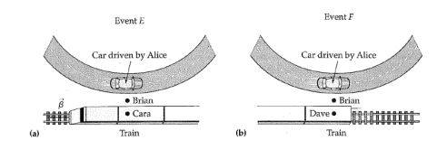

Alice is driving a race car around an essentially circular track at a constant speed of 60 m/s. Brian, who is sitting at a fixed position at the edge of the track, measures the time that Alice takes to complete a lap by starting his watch when Alice passes by his position (call this event E) and stopping it when Alice passes his position again (call this event F). This situation is also observed by Cara and Dave, who are passengers in a train that passes very close to Brian. Cara happens to be passing Brian just when Alice passes Brian the second time (see Figure). Assume that the clocks used by Alice, Brian and Cara are close enough together that we can consider them all to be “present” at event E; similarly, that those used by Alice, Brian and Dave are “present” at event F. Assume that the ground frame is an inertial reference frame.
(a) Who measures the shortest time between these events? Who measures the longest?
(b) If Brian measures 100 s between the events, how much less time does Alice measure between the events?
(c) If the train carrying Cara and Dave moves at a speed of 30 m/s, how much larger or smaller is the time that they measure compared to Brian’s time?

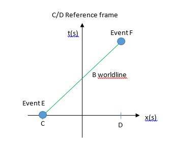

mfb said:
You can find the time C/D measure by considering the reference frame of the train, for example. B is moving from C to D with a known velocity and for a known proper time.
I made the train RF:
so is it correct to use the equation as follows:
$$ Δr_{EF-Brian} = (1-0.5 v^2) \Delta t_{ED-CD}$$
$$ \Delta t_{ED-CD} = \frac{100 }{(1-0.5*(10^{-7})^2)} = \frac {100}{(1-5*10^{-15})} $$
And therefore CD Coordinate time is bigger.
Or maybe should I use the metric equation (but I am not sure its possible due to the data) ?
Correct.
