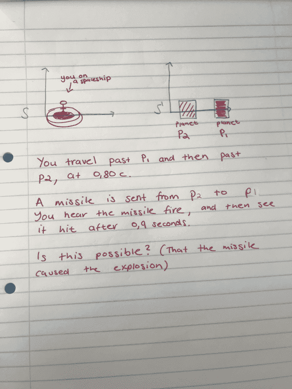

Please see attached image
with distance between planets as 4x10^8m measured by you on the ship
t' = γ(t - ux/c^2)
My attempt:
t' = γ(t - ux/c^2)
γ = 5/3
u = 0.8c
t = 0.9s
x = 4x10^8m
answer is: -0.278
Therefore not possible
My question is what if we traveled rightwards, from p2 to p1, would the answer change?
Should my above information make u = -0.8c instead of +?Thank you

You are on a spaceship moving leftwards (from p1 towards p2).
You hear a missile fired from p2, and then 0.9s later see an explosion on p1.
Is it possible that the explosion on p1 is due to missile fired from p2?
Essentially we determine that the actual time difference between these events is negative - showing the explosion happens before the missile is sent.

I guess the planets are ##4 × 10^8 m## apart in their rest frame?
I'm not sure how you can "hear" a missile. I assume that in your reference frame there are two events separated by ##0.9s##.

So the drawing in the first post is erroneous? The spacecraft is between p1 and p2 at the time the sound is heard?

Yes that isn't accurate. I should have said you see a missile being sent by some light flash.
Yes that's correct about the time.
I was wondering why time dilation formula would give the same result independent if we travel left and right?

No the first drawing is not erroneous.
Question does not specify where we are.

It won't. Let me analyze this problem. First, it's a very poor question. Saying things like "hear" and "see" just creates the misconception that signal travel times are relevant.
Note also that I think it should be ##9s## not ##0.9s##.
The simplest approach is to analyze the situation in the rocket frame. The planets are ##1.6## light seconds apart. Planet 2 fires a missile at close to ##c##, but planet 1 is moving away from the source at ##0.8c##. The missile gains on p1 at a maximum of ##0.2c##, hence takes at least ##8s## to hit p1.
Note that if the planets were moving in the opposite direction, with p1 moving towards the source of the missile, then the missile and p1 would have a maximum separation speed of ##1.8c## and the missile would hit p1 about ##0.9s## later.
Perhaps this is the way the problem is supposed to be?
It makes a difference, therefore, whether the planets are moving in the opposite direction.
I imagine what you did was calculate the time between the events in the planets frame. If, however, you had got a positive time, what would that have told you?
Note that another way to solve the problem was to calculate whether the events are spacelike or time like separated.
There is no such thing as an actual time difference. The 0.9 s you measure is a perfectly valid time difference between the two events. The time you calculated is the time between the events in the rest frame of the planets, but it is not any more valid or real than the time difference measured in any other inertial reference frame. That's one of the basic ideas in special relativity.
If the ship were going in the opposite direction and you still have ##\Delta t = 0.9~\rm s## and ##\Delta x = 4\times 10^{8}~\rm m##, you'd find the explosion occurred after the missile was launched in the rest frame of the planets. Yet one event still could not have caused the other.

Because the missile takes ##8s## in the rocket frame ro travel from p2 to p1. It would make more sense to have the two times close to each other.
Although, actually, I think that perhaps the missile is supposed to fired in the opposite direction, p1 to p2, as that gives a time of close to ##0.9s##.
PS the other thing I don't like about this question is that all the data is given in the rocket frame. There is no reason therefore, to transform to the planet frame.
That seems to be another misconception peddled by some who teach SR: that kinematics in a single frame no longer applies.
PS I thought the distance was ##4.8 \times 10^8 m##, but I see now it's only ##4 \times 10^8 m##.
Anyway, the same principles apply even if the numbers aren't quite so neat!

Alright thank you this helps me understand.
However, I found that the explosion occurs before the missile is sent - therefore events are unrelated.
I am just wondering what would change conceptually and mathematically if the ship traveled opposite direction?
Conceptually, in the frame of the rocket the target would be moving toward the source of the missile.
Mathematically, you would have ##v = -0.8c## in your LT.
Remember also that if another ship is moving in the opposite direction then its measurenents for these events would be different.
Note, finally, that you used ##x = 4 \times 10^8 m## in your calculation. But, that was the position of p1 at time ##t = 0##. At ##t = 0.9s## p1 has moved in the rocket frame.
This is my point about not thinking about the kinematics of the problem.
Likes MyoPhilosopher
