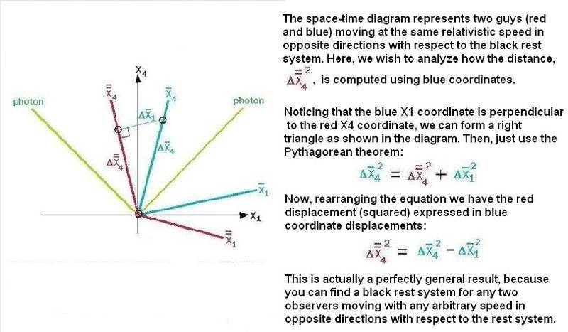

elfmotat and ghwellsjr summed it up pretty well. Here's basically the same point they've made using some graphics.
From this point of view you can see why the Pythagorean theorem doesn't work for the blue guy when he tries to compute an invariant value for a red interval.
In a way, the root cause of this situation (from the standpoint of the space-time diagram) has to do with the unique orientation of the blue and red X1 and X4 coordinates. For example, the direction the blue guy moves in the 4-dimensional universe determines the slope of his world line (his X4 coordinate slope with respect to the black rest system).
Now, the mysterious aspect of special relativity is that blue's X1 coordinate (his 3-D cross-section view of the 4-D universe) rotates such that the 45-degree photon world line always bisects the angle between X4 and X1. This is a perfectly general phenomenon, regardless of the observer's speed, holding for any observer moving relative to the black rest system. Accordingly, this explains why the speed of light is always c, for any frame of reference.
So, in a way, you could ask of nature: Why is it that the observer's X1 axis always rotates in that special manner when the X4 rotates? One possible answer that has been suggested is that consciousness can only pick out a cross-section view of the 4-D universe that is intelligible. And The 4-dimensional objects are arranged geometrically so as to present symmetric relationships among objects that are consistent with the laws of physics. Some would argue that this underlies the discovery of laws of physics. And this is consistent with the fact that the laws of physics are the same in all Lorentz frames.
