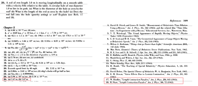

A rod of rest length 1,0m is moving longitudinally on a smooth table with a velocity 0,8c relative to the table. A circular hole of rest diameter 1,0 m lies in its path. The diameter of the hole as seen by the rod is going to be larger?
I guess no, because the length of a moving object relative to another at rest is smaller, from the contraction of length in relativity, but the asnwer is a larger length (1,667m). Why doest it happen?

I'd say you were correct and the answer given is incorrect. Is this from a textbook?

Yes, it is from a textbook. From Resnick, Introduction to Relativity.

I'd have to see a snapshot or scan to believe it. I agree with the OP and Doc.
I also agree with OP and Doc Al, and other posters. Further, this is a classic scenario in SR.

I also would like to see a scan of the text. I think it is more likely that OP is misinterpreting something than that a standard text like this can be in error on such a classic SR problem.

I also wondered if such an error existed in Resnick's text. Wonder no more.

Wow, the text is wrong and disagrees with its references. That is really shocking.
The first book I used when I was self-learning SR was Resnick's text. In retrospect, I feel that it was awful.

Thank you all guys for the support. It was really helpful. I'm learning by myself and I thought I had misunderstood. I appreciate. :)
Quite amazing. Although I didn't use Resnick & Halliday for introductory physics in school I liked their book so much I went & bought it well after graduation - so this is indeed a shocker.
We need to inform Dr. Resnick if we still can, don't know if he's still with Rensselaer Poly.
Or maybe this is his son or ...? (The Resnick of R&H is Robert Resnick. PAllen, what's the name in your SR text?).
