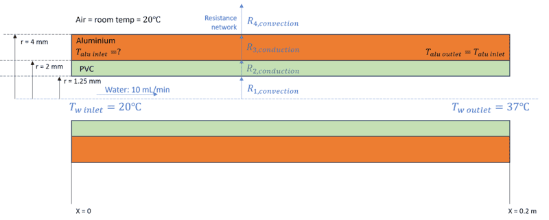

I have a real-world problem whereby:
Water is flowing at a constant flow rate of 10 mL/min through a PVC tube, inner radius of 1.25mm and outer radius of 2mm, that is surrounded by an aluminium shell, inner radius of 2mm and outer radius of 4mm. The length of the tube is 0.2m. Water enters at a temperature of 20 degC and must exit at a temperature of 37 degC. The aluminium shell is heated by an external heat source with an unknown power rating, and the temperature of the aluminium is regulated by a temperature feedback loop (thermocouple). The outside environmental temperature is at room temperature. Determine the power of the heat source required.

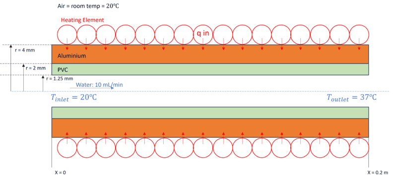

I have made the following assumptions to simplify the problem:
  1. The temperature of the aluminium can be assumed to remain constant, as the temperature feedback loop is designed to keep it a fixed temperature. Additionally, the thermal heat transfer and losses to the surroundings are considered to have negligible impact on the temperature of the aluminium.
  2. Heat transfer between the heat source and the aluminium can also be assumed to be 100% efficient (to simplify the problem).
And I have illustrated the problem in the diagram below:
Which I have simplified with my above assumptions to:

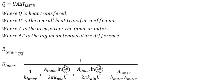

I approached this problem by assuming that it works similarly to a parallel flow heat exchanger, using the LMTD method as below:

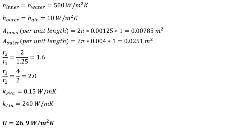

I then solved to find U:

I would like to know:
  1. If this method for solving the problem is theoretically valid, or if you would have approached it another way.
  2. How you might go about determining the minimum power of the heater required to keep the aluminium at this temperature. This will need to balance the power supplied with losses to the environment and heating the fluid.

Before we do that, we have a notational issue. In your original development, you defined Uinner, which involves the summation of 4 terms. But that Uinner doesn't seem consistent with what you call Uinner in post #9, which seems to involve the summation of only the first 3 terms. I continued this version is subsequent posts, but this incorrectly seems to double count the outside resistance. Can you please resolve this?
Interesting - since your first post (post #2) I've been working on the basis that $$ U_{inner} = \frac{1}{ \frac{1}{h_i} + \frac{r_1 ln( \frac{r_2}{r_1})}{k_{pvc}L} + \frac{r_1 ln( \frac{r_3}{r_2})}{k_{alu}L} }$$
Therefore I do not think the outside resistance has been coutned twice, as it's only counted in the ##q_{out}## term.
But the Uinner in post #1 includes the 4th term.
What we are now calling U in posts 10-12 involves all 4 terms, right? The 26.9 value in post #1 is for this U, right?

I would ignore the value and derivation I used in post #1. Since post #2 we have modelled the total heat supplied as the sum of heat in and heat out. The heat out term (##q_{out}##) deals with the convective losses to the environment (1 term), whereas the heat in (##q_{in}##) term deals with conduction through 2 materials and convection to the fluid (3 terms).
In post #7, ##q_{out}## is derived with all all 4 resistive terms included. Note that it would probably be clearer if I had labelled ##U## as ##U_{inner}## in that equation and the one above (##T_3##). From that point onwards the equations have only been rearranged to isolate ##q_{in}##. I am not seeing where any of the resistive terms are duplicated.
For my calculation in post #13 I used: $$ U = \frac{1}{ \frac{1}{U_{inner}}+ \frac{r_1}{r_3h_0}}$$ $$ U = \frac{1}{ (\frac{1}{h_i} + \frac{r_1 ln \frac{r_2}{r_1}}{k_{pvc}} + \frac{r_1 ln \frac{r_3}{r_2}}{k_{alu}} ) + \frac{r_1}{r_3h_0}}$$
Plugging the constants in from post#1 I get ##U = 26.91##
My T* came to 287.91 K - slightly different
