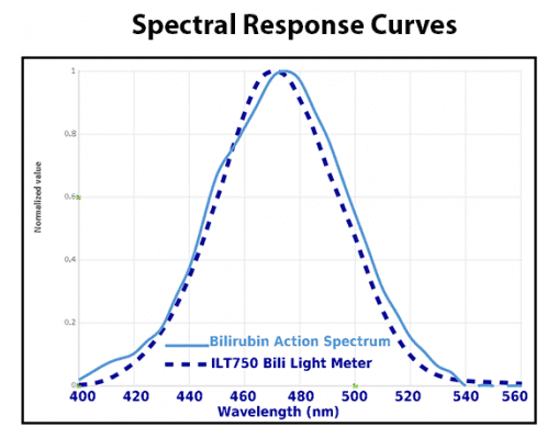

Thanks for the response.
this is the response graph of a measuring device I'm planning on using:
if my LED gives me 450-470nm wavelength range,
you mean i need to do an integral between 450 & 470, then divide it by the response bandwidth (50)?
and btw, is the integral on a constant of the irradiance? or is there some form of equation i need to be aware of?
also, if this is my response curve, what is the divide value?

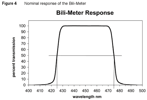

Perhaps one of us misunderstood the other one.
We are talking about a measuring device, yes? Not a filter. I want to measure the spectral irradiance, and validate it with calculation.
What exactlly is fig4?? Percent transmission through what??
From: https://www.hkcalibrations.com.au/bili-meter
Measuring Irradiance​
The Bili-Meter is a spectroradiometer that measures the therapeutic irradiance (radiant power) of neonatal phototherapy lights. It measures the irradiance of the wavelengths from 425 to 475 nanometers (nm), the blue-green portion of the spectrum, which includes the principal action spectrum of bilirubin.
Units of Measurement​
The Bili-Meter measures irradiance in units of microwatts per square centimeter per nanometer (pW/cm2/nm). A nanometer is a inmsure of wavelength equal to one-billionth of a centimeter. The term "per nanomcter" indicates the average irradiance per nanometer across the spectral hand being measured, which is 50 nm wide. This makes it possible to compare average irradiance across spectral bands of different widths.
Cheers,
Tom
through a measuring device. it's a response graph.

i actually found it before and even presented the graph from there. it's one of the measuring devices i consider using.
from their description I'm still not sure of the exact calculation needed.
i would be happy if someone gives me an example with units and all.

The photosensor already does the integration for you. You put a bandpass filter in front of the photosensor to restrict the wavelengths you want to measure.
If the photosensor does not have a flat response over the desired wavelengths, you will have to account for that. Probably 10 points across your filter spectral width would be plenty.
If the filter passband is not flat, do the same correction as for the photosensor.
Then divide the corrected reading by the width of the bandpass filter, 50 in your case because the filter passband is 50nm wide. See the bolded sentence in post #12 above.
Be sure to account for the transmittance of the filter, it will reduce the amplitude to some extent.
