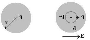

In the next few posts I'm going to sketch a couple of "semi-derivations" of some important and useful concepts.
The first is a simplistic argument to help you feel comfortable the idea of polarizability - and that's a key character in the Spectroscopy story. I'll run through a quick derivation to help this idea stick.
Consider an isolated atom which we shall approximate as a pointlike nucleus of positive charge 'q' at the center of a spherical cloud of negative charge '-q' and radius 'r' (fig 1).
An external electric field is applied, which separated the centers of positive and negative charge by a distance 'd'. Now, in equilibrium, the force on the positive charge from the field must equal the opposite force from the negative cloud. The force due to the negative cloud can be calculated from the electric field due the this cloud at the position of the positive nucleus.
[tex]F (external~ field) = qE [/tex]
[tex]F (negative~cloud) = qE_{cloud}[/tex]
The value of [itex]E_{cloud} [/itex] follows directly from Gauss' Law :
[tex]E_{cloud} = \frac{q}{4\pi \epsilon_0 d^2} \cdot \frac{d^3}{r^3} [/tex]
[tex]\implies ~F (negative~cloud) = \frac{q^2}{4\pi \epsilon_0} \cdot \frac{d}{r^3}[/tex]
Setting these forces equal to each other gives :
[tex] qE = \frac{q^2d}{4\pi \epsilon_0 r^3} [/tex]
[tex]\implies qd = (4\pi \epsilon_0 r^3) ~ E [/tex]
Noticing that the quantity on the left is nothing but the dipole moment, this gives :
[tex]p = (4\pi \epsilon_0 r^3) ~ E = \alpha E~,~~say[/tex]
The proportionality constant [itex]\alpha[/itex], is called the polarizability. So, we have :
[tex]\alpha = 4\pi \epsilon_0 r^3 = 3 \epsilon_0 V[/tex]
where V is the volume of the atom.
The moral of this simplistic argument is that the polarizability can be thought of as a quantity that is proportional to the atomic/molecular volume.
This is a very handy Rule of Thumb to keep in mind. It will be useful later, to help identify when the polarizability changes - all you have to do is look for a change in the volume of the molecule.
