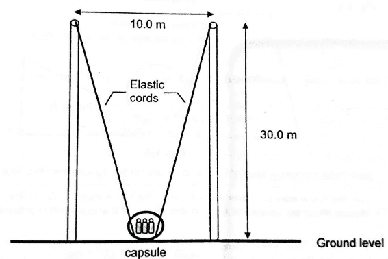

This is set up of reverse bungee jumping (see picture below). The total mass is 500 kg, the original length of cord is 25 m and total elastic potential energy at ground level is 0.6 MJ. Find:
a. speed of capsule when the cords first become loose
b. position where the apparent weight of the person inside it will be the greatest
Conservation of energy
Newton's Law
a. To find the speed, I need to find the height where the cords first become loose, which is when the cord is 25 m long.
$$h=30-\sqrt{25^2 - 5^2}$$
But the teacher's working is ##h=30-\sqrt{25^2 - 4^2}##
How to get 4?
b. My idea is to use Newton's 2nd law so I draw free body diagram of the person inside the capsule. There are two forces, normal force acting upwards and weight acting downwards. The apparent weight is the normal force acting on the person. The equation of motion is:
$$N-W = m.a$$
$$N=W+m.a$$
So the apparent weight is the largest when the acceleration is the largest. How to know the position where the acceleration is the largest?
Thanks

Perhaps there is some information in the original problem description on the width of the capsule, or more specifically, the distance between the two cord attachment points on the capsule?

You are correct. I just asked my teacher and he said there should be information about effective diameter of the capsule, which is 2 m. Now I understand how to get 4 (I draw the diagram when the length of each cord is 25 m)

As you noted in post #4, max apparent weight corresponds to max normal force and thus to max acceleration. What vertical forces act on the person+capsule? Which of these is variable? At what position is it maximised?

Vertical forces are two tensions directed upwards and weight. The equation will be:
$$2T \cos \theta -W=m.a$$
where ##\theta## is angle between the cord and vertical
To get maximum ##a##, it means that both ##T## and ##\cos \theta## should be maximum. ##T## is maximum when the cord has maximum extension and ##\cos \theta## is maximum when the angle is the smallest so the position where the apparent weight is the largest is at the lowest position when the capsule starts to move.

Yes.
