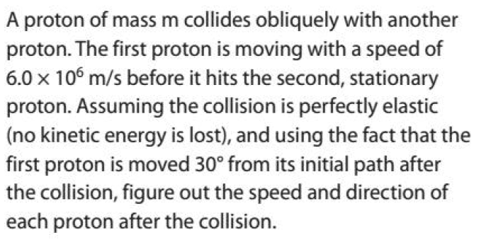

I don't really understand the question. A proton collides obliquely with another proton means that the first proton moves at certain angle with respect to horizontal?

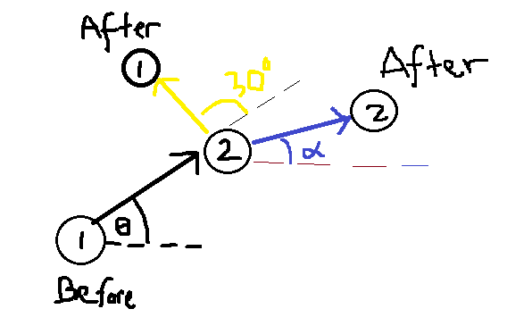

This is my sketch:
Is that correct? If yes, is it solvable since there are so many unknowns?
Thanks

Yes, it is solvable. You need to calculate the direction of the target proton relative to the initial direction of the incident proton. Your angle ##\theta## is unncessary - you may take ##\theta = 0##.

Do you know how to change to/from the centre-of-mass frame of reference (which often simplifies collision problems)?
Also note, in Post #1:
- the angle marked as 30º looks more like (about) 100º!
- there is no reference to ‘the horizontal’ in the original question; for convenience, we typically choose to have the incident photon traveling along the x-axis (in the +x direction) - the same as using θ=0 as already suggested by @PeroK;
- the angle marked α is not the one you should be trying to find!
If you need further help you might want to redo and repost the diagram as it is misleading as it stands.

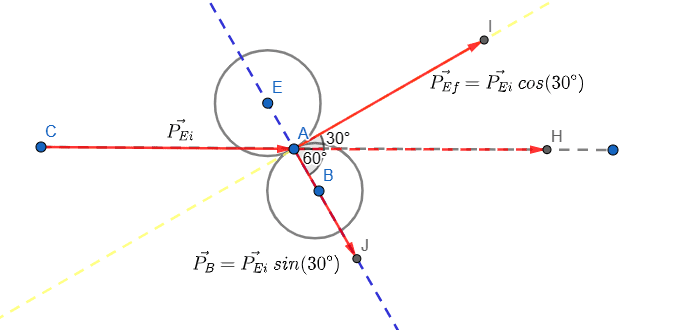

A bit of experience playing pool is useful. In a collision between the cue ball and a target ball there is a simple relationship between the angles at which the cue ball and the target ball depart from the collision.
Likes hutchphd, Steve4Physics and songoku

Yes, I realized it from post#2, that's why I changed the position of the angle in post#3 but sorry I didn't change the sketch.
Thanks

Or use the Pythagorean theorem and geometry.
Call the impacting velocity ##v_0## and the departure velocities ##v_1## and ##v_2##. By conservation of momentum, ##\vec{v_0} = \vec{v_1} + \vec{v_2}##. This means that the three vectors form a triangle.
By conservation of energy, ##\frac{1}{2}mv_0^2=\frac{1}{2}mv_1^2+\frac{1}{2}mv_2^2##. Divide out the ##\frac{1}{2}m##. Now you have ##v_0^2=v_1^2+v_2^2##.
But that's the Pythagorean theorem for right triangles. If the triangle is a right triangle, the sides have that relationship. And conversely. If the sides have that relationship then the triangle is right.
Which brings us back to the pool table and those balls departing at a particular angle from one another.

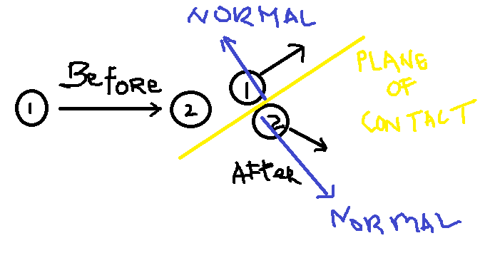

Well, no, it does deal with velocities, but it is the relative velocity components normal to the plane of contact. I've always used it in conjunction with momentum rather than using energy + momentum because it avoids the quadratics.
Likes songoku

That still needs to be prefixed by specifying the components normal to the contact plane. And the sign only becomes clear by assuming the bodies can't pass through each other. Using velocities it's embodied in the equation.
Likes songoku
By normal to the plane of contact, do you mean this?
Thanks
Yes.
The impulse is normal to the plane of contact. (For spheres, that means it is along the line joining the centres, but that is not so in general.)
So neither body will undergo a change in velocity parallel to the plane of contact, and you can apply momentum conservation and NEL normal to it. That also applies for collisions that are not perfectly elastic.

As you might know, for a perfectly elastic full on collision between two identical balls, one starting at rest, the incoming ball comes to rest. Applying what I wrote in post #23, it follows that in an oblique collision the incoming ball loses all its velocity normal to the plane of contact. Hence, the balls will move off at right angles to each other.
Likes songoku
Thank you very much neilparker62 for such a nice sketch
Pleasure - hope it helps understand the problem! Geometer's sketchpad is a great online tool for this type of sketch.
