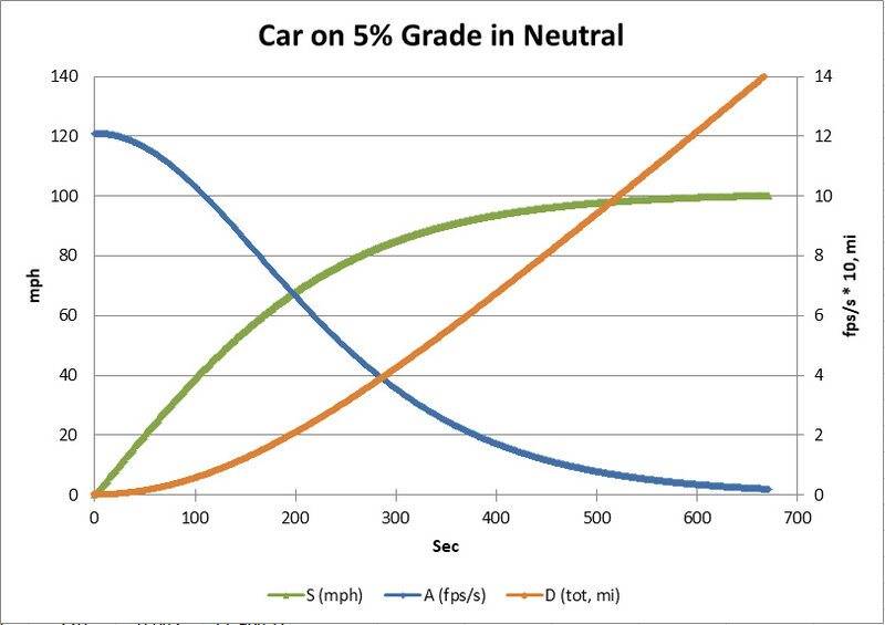

Ok, let's try this as a data point for a model:
I've previously calculated that for a car traveling 60 mph (88 fps) and getting a pretty normal fuel economy of 30 mpg, its engine is putting out 17 horsepower. Arbitrarily I'm going to guess 25% rolling resistance, 25% drivetrain loss and 50% aerodynamic drag/actual propulsive force. That's 53 lb of drag/propulsive force.
If the car weighs 4,000 lb, sitting on a 5% grade is 200 lb of force along the incline, minus 50 for rolling resistance (in neutral, so drivetrain loss is assumed zero), so 150 lb of force accelerating the car, for an initial acceleration of 1.21 fps/s. Vs our 53 lb of force at 60 mph, that's a top/terminal speed of 101 mph.
Throwing that into a spreadsheet, I get 13.1 miles (along the slope) to terminal velocity (at 99% of terminal velocity). That's more than I expected, but still a much more manageable 3,500 ft hill.
Certainly these numbers can be refined and will vary based on weight/drag.
[Edit]
That top speed seems high. Back-checking, gravity is providing 54 horsepower at that speed. Using the 25% drivetrain loss assumption, that's 72 horsepower at the engine. I had an Eagle Talon with a ridiculous 92 hp engine that still did about 115 mph, so that's actually right in the ballpark.
...I did have a little error, calculating 48 lb instead of 53 lb of force at 60mph for the example case. Corrected.
Likes bob012345, anorlunda and hutchphd

I would be curious to see what the acceleration vs. time curve looked like and if the velocity vs. time curve looks like a damped oscillation?
bob012345 said:
What was the terminal velocity under your assumptions and what does the curve of acceleration vs. time look like?
Note the slight correction. What you quoted says terminal velocity of 106 mph but I re-checked, found a little error and corrected to 101. Graph (note, the acceleration is x10 for visibility):
Likes bob012345

So need to specify the starting altitude as it would likely reach terminal velocity quicker and earlier. Some of those routes between New Mexico and Colorado might alter the arithmetic!
... 100mph sounds reasonable, considering engineering estimates ...
