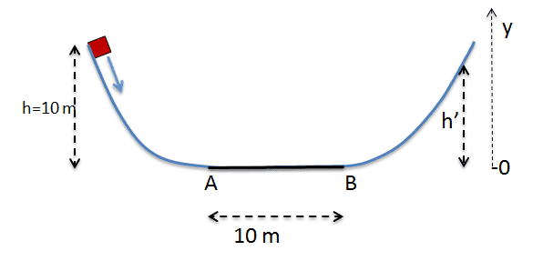

An object of mass m=2 kg slides down on a track from a height of h = 10 m. The track is frictionless except the horizontal range between the points A and B. The friction force is constant between A and B. What is the speed of the object at point B if the magnitude of the friction force between A and B is f = 10 N (take g = 10 m/s2) .
F = m (dv / dt)
KE = 1/2 mv^2
The potential energy while sliding down would be U=mgh=2x10x10=200 J[/B]
I have no idea what to do after this point.

What equation connects work and force?
W = Fdcosθ
AlexanderIV said:
W = Fdcosθ
Can you apply that to the strip AB?
If I apply it would be W = Fdcosθ = (mgsinθ)x10xcos0= (2x10xsin0)x10x1=0 but that does not make sense to me.

What force affects the speed?
The gravitational force affects the speed. Then it should be W = Fdcosθ = (mg)dcosθ = (2x10)x10x1 = 200 J?

No, I mean along the strip AB.
The friction force.
AlexanderIV said:
The friction force.
So write the energy equation in relation to that.
W = (mgsinθ - kmg)dcosθ = (2x10x0 - kx2x10)x10x1 = (0-20k)x10 = -200k J ?

I assume k represents the coefficient of kinetic friction, but you are not given that. You don't need it because you are given the actual frictional force.
Then it should be -100 J but I don't know how I could relate that to the speed.

You don't know how a change in energy relates to a change in speed? You quoted an expression for KE.
-100 = 1/2mv^2 => -100=v^2 => -100=v^2
But this is not possible, is it?

It started with some energy. The work done by friction is only a deduction from that.
It started with potential energy, so W = Fdcosθ = (mgh - f)dcosθ = (200 - 10)10 = 190 x 10 = 1900 J?

That makes no sense. You are subtracting a force from an energy term.
What energy did it gain by descending, and what does it lose to friction?
