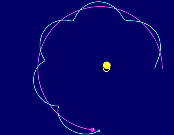

The idea of "not having an orbit" as an argument against relativity is flawed anyway.
If by "orbit" he means a closed orbit then, for an observer for which the sun moves, the Earth does not describe a closed orbit. Even if the gravity is instantaneous and using just classical mechanics.
In a similar way, in a frame fixed to the Sun, the Moon does not move on a closed orbit around the Earth but rather something like this.
And this is not a due to finite "speed of gravity".
