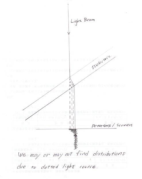

Please find below illustrated my idea of experiment .
