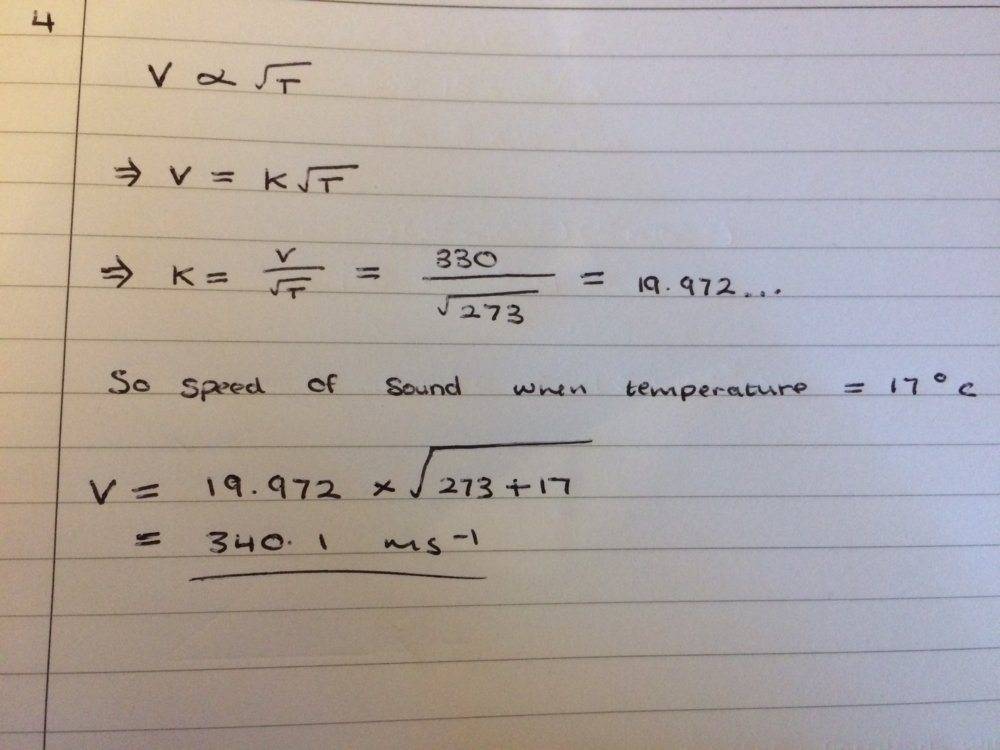

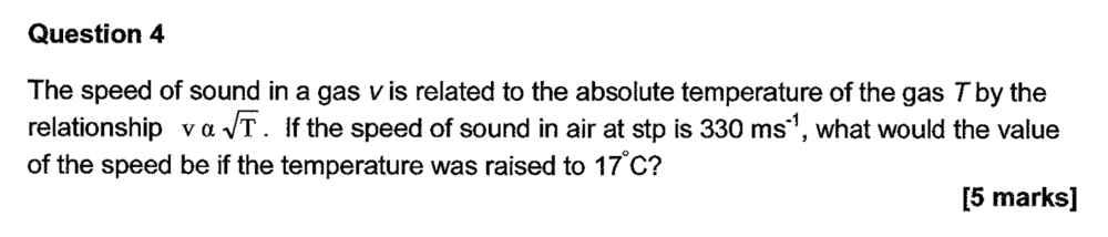

See image attached below
v = k * sqrt(T)
Here is the Q
Very unsure about how to approach this question but this is what I have tried
Any help would be really appreciated! Thanks
Your calculation of the multiplier, k, is not really necessary. The velocity of sound will change in proportion to ##\sqrt T ##, so you can scale velocity by ##\sqrt {T_1} / \sqrt {T_0} ## without even knowing what k is.
Likes Bolter and berkeman
Thank you, I have tried this and get the same value again. I'll keep a note of using next time I get a similar problem :)
