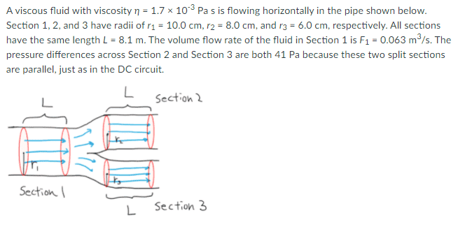

A viscous fluid with viscosity η = 1.7 × 10^-3 Pa s is flowing horizontally in the pipe shown below. Section 1, 2, and 3 have radii of r1 = 10.0 cm, r2 = 8.0 cm, and r3 = 6.0 cm, respectively. All sections have the same length L = 8.1 m. The volume flow rate of the fluid in Section 1 is F1 = 0.063 m^3/s. The pressure differences across Section 2 and Section 3 are both 41 PA because these two split sections are parallel, just as in the DC circuit.
{I am given a diagram with a single pipe splitting into two pipes, flow arrows all pointed to the right, with the L sections being the flat horizontal areas, L sections not including the distance.}
(a) What is the speed of the fluid in Section 1?
(b) What is the volume flow rate in Section 2?
(c) What is the speed of the fluid in Section 2?
(d) What is the speed of the fluid in Section 3?

Can you post an image of the diagram? That would help.
If VFR = Av, you can't then say VFR = ηvA/L. That would require viscosity to have the same dimensions as length, which it doesn't. (It also implies that flow rate is greater the higher the viscosity, which is counter-intuitive. Look up the Poiseuille equation.)
You can't assume that either the velocity or the VFR are the same between sections 1 and 2. What is true is that the total VFR for sections 2 and 3 is the same as that for section 1.

Here's the picture!
Did you look up the Hagen-Poiseuille equation yet?
