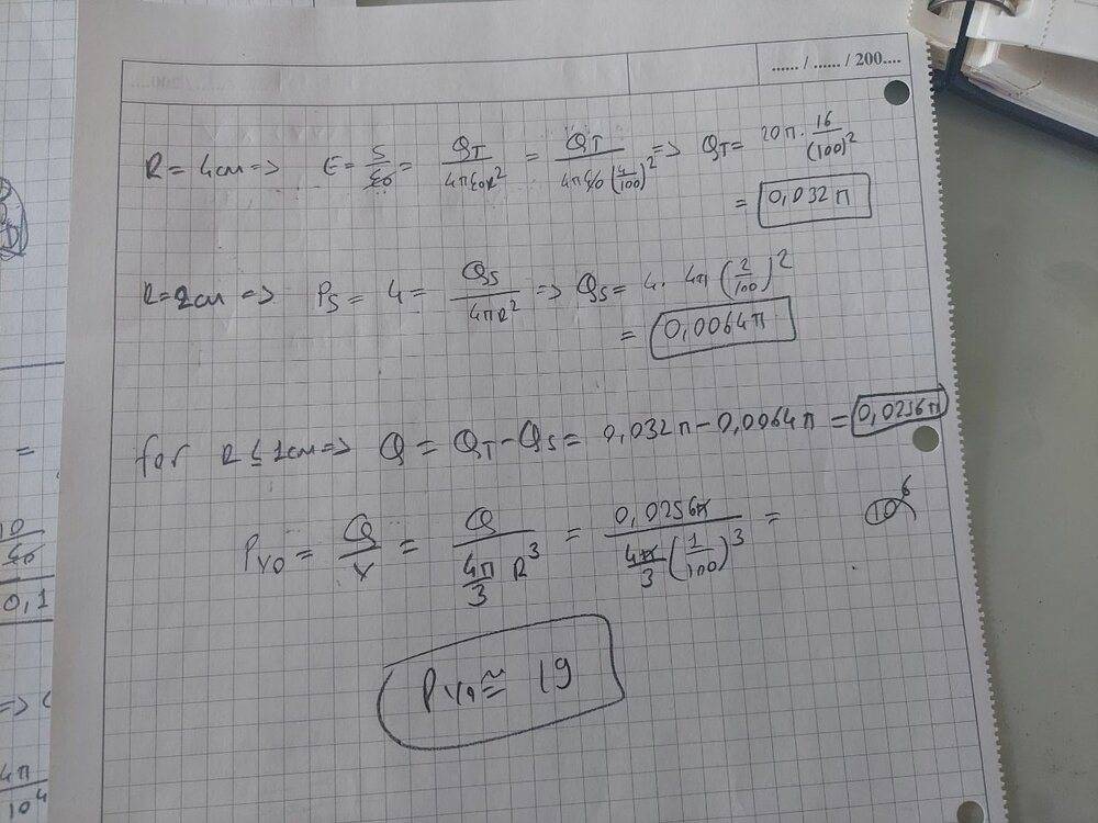

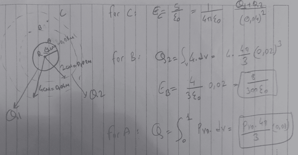

A spherical volume charge (R<=1cm) with uniform density ρv0 is surrounded by a spherical surface charge ( R=2cm) with charge density 4 C/m2. If the electric field intensity at R=4cm is 5/Є0 ,deterime ρv0

sorry, ı am new in electromagnetic and it is so difficult for me
It seems you know something about Gauss' Law but you made some mistakes when you computed Q1 and Q2. Q1 comes from a volume distribution whereas Q2 comes from a surface distribution. The scanned page shows some confusion about this point.
Likes berkeman
ok. Where else could I have a fault
I'd say the scanned page is just a sketch and I find it difficult to read. Please, try to post your ideas first and make a more detailed attempt.
ı found pvo=1900. is there a wrong calculation? please write me
Some thoughts:
1)The numbers, and just the numbers, are OK but:
2) 5/epsilon0 can't be an electric field. Units don't match.
3) Please; use units!
4) Did you find rho= 19 C/m3 or 1900 C/m3?
5) Please, write down the ideas behind your reasoning.
Mohomad said:
ı found pvo=1900.
Check the order of magnitude in your final step to that.
