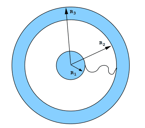

Consider a spherical conducting shell with inner radius R2 and outer radius R3, that has other spherical conductor inside it with radius R1 (this one is solid). Initially the 2 spheres are connected by a wire. We put a positive charge Q on the sphere and after some time we remove the wire that connected the 2 spheres.
What is the charge distribution of charge on the 2 spheres after we remove the potential? If we have charged the inner sphere instead, would the result be different?
Gauss's law
Electric field is the negative gradient of electrical potential
The answer provided was that the charge would all flow to the outer surface of the spherical shell, and the same would happen if we had placed Q on the inside of the conductor shell.
Now I'm trying to find an explanation to this.
At first I thought that because the electric field between R2 and R3 needs to be zero by Gauss law (we are inside a conductor), then the interior charge needs to be zero. Because of that all the charge will flow to the outside. But I don't think that makes sense because we could still have charge outside the inner sphere and on the inside surface of the shell if those charges would be on equilibrium...
Can someone please clarify me about this?
Also I don't understand what would happen if we didn't add charge Q to our system, would the result be different if we didn't add it?

If you have two concentric shells, each uniformly charged (but not necessarily with the same charge or charge density) then in the space between the shells:
- the potential generated by the outer shell is uniform
- the potential generated by the inner shell is non-uniform
- therefore the total potential there, the sum ofthe two potentials, in non-uniform.
It follows that if the two shells are connected by a conductor the charge distribution is unstable. Stability can only return when there is no charge on the inner shell.
When you say"connected by a conductor" you don't mean wire right? Because when they are connected by a wire the difference of potential is zero right?
Also I think I misunderstood before what you meant with inner shell and outer shell.
By inner shell did you meant the space between the sphere and circular shell (white on the following draw) and by outside shell you meant the outside of the conductors?

I'm really confused right now so let me rephrase my question.
I understand and it makes sense to me that all the charge is on the outer surface of the shell.
My 2 questions were:
- why is it not possible that we have for example (I will call totq the total charge in a surface): -totq in the inner side of the shell; +totq in the surface of the solid sphere. Is it because of the non-uniform potential that would be created?
- I also asked about the influence of the charge placed on the system (in the 1st case in the outer surface of the shell and in the 2nd case on the surface of the solid sphere). If that charge was not there, would charge flow after we remove the wire?
For each of the two conducting shells, all of its charge must be on the outer surface, for the reasons I gave in post #13.

So charge flows to the outside because they are connected initially by the wire?? Why? Shouldn't the solid conducting sphere have the same potential as the inner surface of the outer shell? Why does that potential need to be zero? Is it because of the fact that if it wasn't zero than no charge. But the solution says that the charge flows to the outside after we remove the wire...
You are confusing the net potential of that sphere with the potential due only to its own charge.
The charge on the outer shell generates a potential everywhere inside itself. To get the net potential you must add any from the solid sphere. With all charge having left th solid sphere, that adds nothing, so everywhere inside the shell has the same potential.
