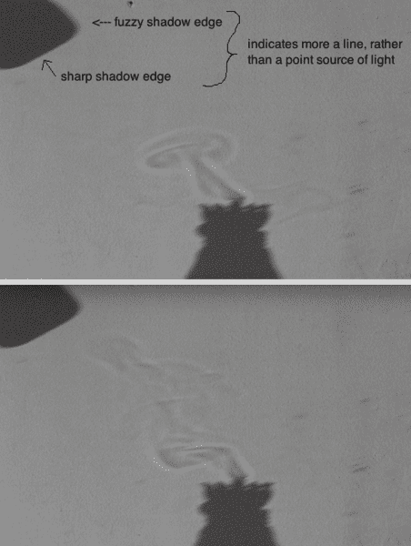

Can't help you with your specific problem of finding a cheap "concave" lens, but you might want to experiment with a "convex" lens.
I discovered last Halloween that a vehicle's windshield produced almost the same effect, when shining into my living room.
Here's what I witnessed when I put an oil lamp in line with the light, and took an image on my living room wall:
Kind of "dollar store-ish". But still, kind of fun.
It appears that I stumbled across something called "Shadowgraphy".

Guessing that it's the "exorbitant cost" that has kept me from studying this further.
But I find it fascinating that REALLY OLD people could do this:
Schlieren [wiki]
History
Schlieren were first observed by Robert Hooke in 1665 using a large concave lens and two candles.
And I'm scratching my head, 353 years later; "How did he do that!"
