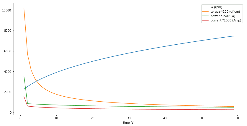

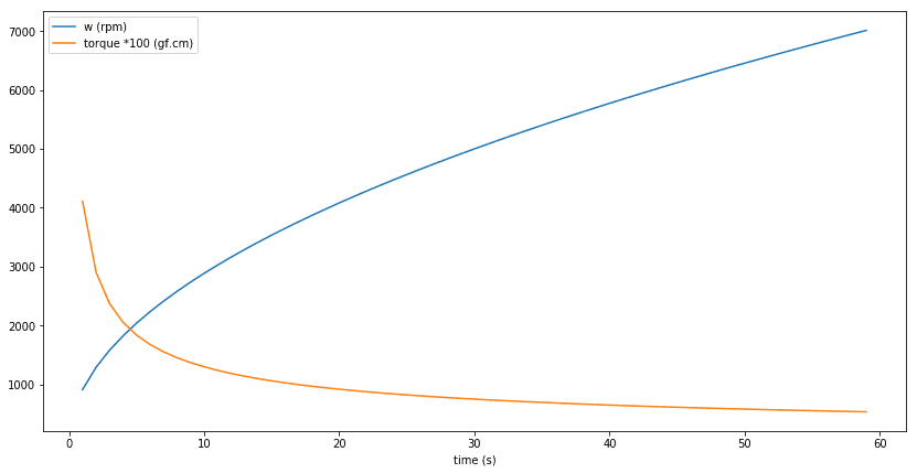

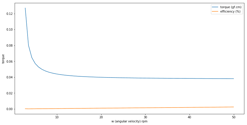

i'm simulating a small dc motor that is driven by volt = 1.54v, current = 250 milli amps, so that gives me 0.385 watts supplied to the motor
next i attached a 4mm thick circular acrylic disc as a flywheel. so in this simulation i spin up the acrylic disc as a flywheel
my acrylic disc is 12cm (4.7") diameter.
acrylic density 1.18 g/cm cube
https://www.engineeringtoolbox.com/density-solids-d_1265.html
next i get the relevant equations:
https://en.wikipedia.org/wiki/Flywheel
E = 1/2 . I . w^2 ... (1)
I ~ moment of internia
w ~ angular velocity
https://en.wikipedia.org/wiki/Torque
power = torque . w ... (2)
then from (1):
E / t = 1/2 . I . w^2 / t
power = 1/2 . I . w^2 / t ... (3)
w = sqrt ( 2 . power . t / I )
now i assume power is that coming from the motor which is 'constant'
so in this way i can plot the angular velocity over time
next subst (3) into (2):
1/2 . I . w^2 / t = torque . w
torque = 1/2 . I . w / t
so in this way i can plot the torque over time

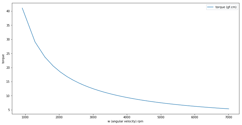

the results look 'surprising', apparently the torque falls even as the acrylic disc / flywheel is spun up (this still seemed quite 'ok')
next the angular velocity i converted it to rpm (revolution per minute) increases but is not linear
what is a little astonishing is the disc spinning at 7000 rpm after 60 secs for a 12cm (4.7") x 4mm thick acrylic disc
that motor delivers a minuscule 0.385 watts !
any mistakes in these calcs?

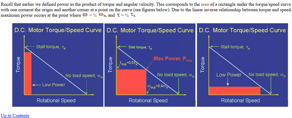

i've seen that
http://lancet.mit.edu/motors/motors3.html
then as google would take me, I've seen other astonishing charts
https://www.orientalmotor.com/stepper-motors/technology/speed-torque-curves-for-stepper-motors.html
http://www.mechanicalengineeringsite.com/how-to-read-the-speed-torque-curve/
the fictional motor is literally real (the ebay equivalent)
https://www.pololu.com/product/1117
i'm actually trying to measure the stall speed of the motor, but the other curvy wandering charts makes me to curious to probe further. this 'flywheel' is a 'dynamometer', sort of.
if the calcs are correct, i can literally measure torque from the motor in this way, by simply spinning up a disc ! ;)
the 'constant power' assumption comes from the notion that the power supplied to the motor is I (current) x V (voltage). if we assume a 100% efficiency. then that 'power' should be transferred to the flywheel. and if these assumptions and calcs are correct. the flywheel should trace out the rpm - time curve or torque - time curve. the thing is I've nothing to measure torque, i can only measure the speed (angular velocity) . but these calcs are kind of surprising in that small amount of power can drive a rather large (about 50 grams) acrylic disc measuring 12cm (4.7") diameter, 4mm thick to 7000 rpm in 1 minute with only 0.385 watts.
Did you check your calculations as being correct by comparing the electrical energy input to that gained by the flywheel after a time frame.
That is a way to determine if you are on the right track.
It is often "surprising" how little energy mechanical stuff needs compared to heating. For example lifting a certain amount water versus heating it up by 1°.

think so too, a little trouble is that this experiment if realized would turn into a little project to build a flywheel inertia dynamometer, rpm sensors and all. I'm trying to figure out in what other ways can i use it, e.g. to plot the torque - speed (rpm) curves of the motor. so far only these curves are figured out from the flywheel physics, I've not yet figured out how to create the other data points that would form those important torque - speed (rpm) curves for motors. if building this would only verify these curves, it would feel like a one off use for all that effort
" but these calcs are kind of surprising in that small amount of power can drive a rather large (about 50 grams) acrylic disc measuring 12cm (4.7") diameter, 4mm thick to 7000 rpm in 1 minute with only 0.385 watts. "
So you supllied 0.385 x 60 = 23.1 J
The block has a mass of 0.05 kg so 23 J of KE could propel the whole block at 30 m/sec. The periphery of your disc is moving at about 44 m/sec, but the rest of the disc is slower. (I'll leave it to you to do the sum using rotational KE.)
"i'm actually trying to measure the stall speed of the motor, " Zero !
"the 'constant power' assumption comes from the notion that the power supplied to the motor is I (current) x V (voltage). if we assume a 100% efficiency. "
!00% is never true, though it might be good at high revs. At low speed, during early acceleration, efficiency increases from zero.
But depending on when you measured the current, you may have under or over estimated the power input.
"i'm simulating a small dc motor that is driven by volt = 1.54v, current = 250 milli amps, so that gives me 0.385 watts supplied to the motor "
It isn't. If the voltage is fixed at 1.54 V, then the current isn't fixed. If the current is fixed at 250 mA, then the voltage will vary and eventually may not be able to sustain the current anyhow.
Since you are doing a simulation, what parameters can you put in for the motor model?
Likes berkeman and ag123

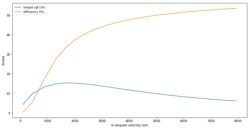

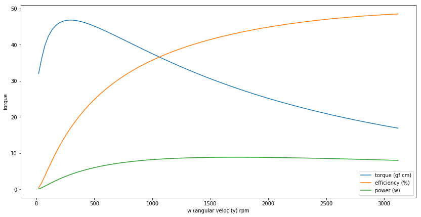

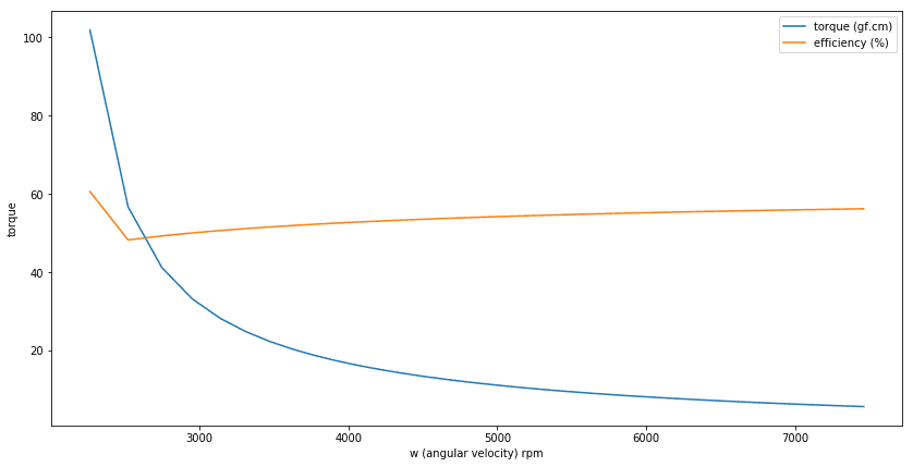

i think these curves, especially the 2nd curve are the 'ideal' curves, as it is based solely on the physics of the flywheel. if i run the motor at different levels of power it would trace multiple sets of the 2nd curve.
what i may have ignored is that for a real motor, the higher end of torque (on the left) may be less, i.e. the motor slips (stall). but then that is strange as it would imply that for a heavy flywheel, it may not turn at all even if the flywheel axle is frictionless. this sounds strange and unintuitive, there seem to be something else missing in the model.
but these curves are interesting if they are true, it gives you the torque-speed (rpm) performance of the motor at a particular level of power
It's not clear which curve you are talking about? Is this in post #1 or #2?
That said, I can't see how either implies that a heavy flywheel won't move?
There is a high torque at low (or zero) speed, so it will accelerate.
Where it will not accelerate is when it is already moving very fast at the right hand side of the graph and the torque drops to the level of friction.
One question is where you got your post #1 graphs from? If you got them from your calculations, they are wrong. You must go back to your calculations and get rid of your false assumptions of constant input power and constant torque.

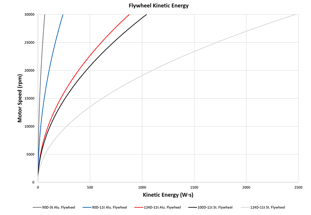

ag123 said:
... this experiment if realized would turn into a little project to build a flywheel inertia dynamometer, rpm sensors and all...
You could compare yours to typical graphics of inertia dynamometers for DC motors.
Copied from
https://en.wikipedia.org/wiki/Dynamometer
"An inertia dyno system provides a fixed inertial mass flywheel and computes the power required to accelerate the flywheel from the starting to the ending RPM.
It calculates the power required to accelerate that fixed and known mass, and uses a computer to record RPM and acceleration rate to calculate torque."
Please, see:
https://www.minipro.com/products/electric-motor-dyno

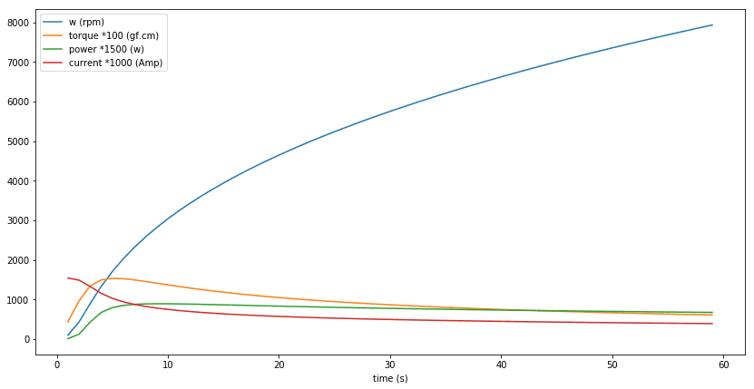

this is a surprise too, note that the torque is the implied torque on the flywheel alone if that much power is supplied (0.385 W). it would then goto the notion of motor slip and stall, on the notion that the motor would simply stall and slip if it can't supply that much torque.
my thoughts are that then the flywheel would spin up at a lower level of power, i.e. power = torque x angular velocity, in which the 2nd curve (torque v rpm) would shift downwards nearer to the x and y axis
the curves would also look very different from these 'ideal' curves which is just the flywheel alone.
as initially the motor slip but the flywheel turn with less torque, but at some point the motor would 'catch up' as it can supply the necessary torque and the power transmitted to the flywheel would actually go up

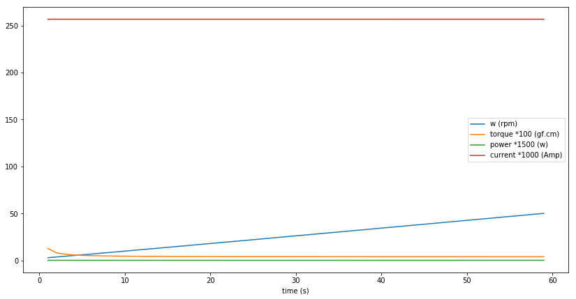

thanks, that makes sense, but assuming that the disc is attached to the motor and i spin up the disc while the measured voltage ( 1.54v ) and current (250 mA) stays the same the power delivered would be the same during that time. but of course, this is also an assumption, what would be more interesting is when the disc is spinning up, would power actually go up or down? my thoughts are that it may go *down* as back emf would develop in the motor as rpm increases and eventually it reaches a fixed rpm speed. at that point power input V x I = resistance loss + friction loss + back emf 'loss'
so that the power added would keep the disc spinning at that maximum speed.
unfortunately, this is the part i wish to model as well and I'm currently unsure how to model that process. it would make the model more accurate. i.e. even if i can fix V (voltage), while the disc is spinning up actually I (current) would literally reduce.

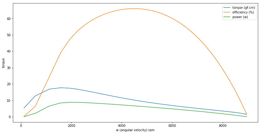

You have failed to understand post #2. DC motors are not 100% efficient. They do not go to infinite torque at zero RPM. They do not slip. They do not stall. They simply provide non-zero torque at zero RPM.

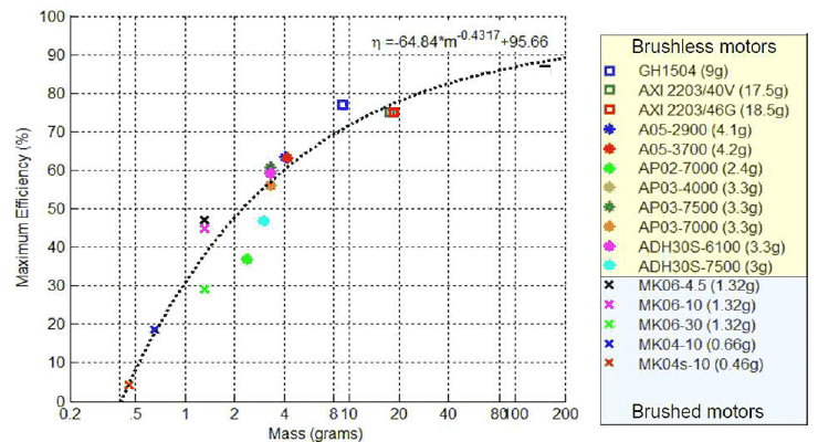

I don't understand why do you want to simulate electromotor powered by 1.5 V and less than 1W input.
Do you know how low is the efficiency conversion of electrical input to mechanical output for a very small motor (even of brushless DC type) at high RPM? Very low. Much less than 50%

ag123 said:
small motors do have uses, they are everywhere. in all sorts of appliances, actuators etc.
and this calc isn't limited to small motors. tiny hard disk motors spins the hard disks at easily 10000 rpm
And hard disc motor efficiency is?
near 80% or closer there

The point is if you want to have more realistic simulation you need to know η(rpm) curve for a given motor.
For smaller motors the influence of the small efficiency figures is bigger than for bigger motors.
If you want to simulate η=100% cases* than ok, but results will be more or less unrealistic.
* impossible, even in principle for induction motors!

The relationships are linear and they really are pretty straightforward:
https://www.micromo.com/technical-library/dc-motor-tutorials/motor-calculations
Your input voltage is fixed and your constants are fixed. So then back-emf is a linear function of rpm. You can plug it all into one equation and solve for torque vs rpm or do it in steps, but the equations and example in that link make it pretty easy.
[note: in the graph, the torque line is mislabeled as "speed"]

  • #32
thanks russ, your tips helped !
i made some improvements in the model
back emf = k . phi . w = k . i . w
phi is the magnetic flux which is proportional to current, hence substituting current in place
k - back emf constant
https://en.wikipedia.org/wiki/Motor_constants#Motor_velocity_constant,_back_EMF_constant
this back emf term also accounts for the power output supplied to the disc
https://en.wikipedia.org/wiki/Lenz's_law
voltage is held constant from the power supply in this analysis
voltage = voltage over resistance + back emf
v = i . R + k . i . w
i = v / ( R + k . w )
so in this way current now decreases as angular velocity increases
power output to the disc = back emf x current
Pout = k . i . w . i = k . i^2 . w
now this power is supplied to the disc and spins the disc up
the jupyter notebook is updated
https://www.kaggle.com/ag1235/flywheel
and the charts looks as follows
they still looks quite similar to the 1st post, but there is a surge in torque and power initially as i use the power supplied to the disc as Vin^2 / R only at startup , where R is the motor resistance. this is needed as at start w (angular velocity) is zero and it would give a zero power with the back emf formula (p = k . i^2 . w)
what is noticeable in this simulation is that the power remains rather level (nearly constant), even though current actually decreases. this in part as the increasing rpm actually offset and perk up the output power. the upwards concave torque v rpm chart basically results from a near constant power input as p = torque x angular velocity. Hence, torque = p / angular velocity
efficiency at around 50%, i used Pout / Ptotal = Pemf / (i.r + Pemf) as the formula. resistance value of 1 ohm is used. zoki85 is right, the efficiency of these motors can be low, in particular if the winding resistance is high.
this simulation is probably still imperfect but at least it accounts for the resistance and back emf in some ways. the charts still looked relatively similar as the 1st post
i wondered for a while if using Pemf (the power as is suggested by the back emf) for the power supplied to the disc being correct? i think it is correct, the power isn't lost, the energy is stored in the disc (flywheel) spinning at those rpms. this is probably a simple flywheel energy storage system, spin up the motor, that power is used to spin up the disc. when you cut off power and supposing there is another load (say a filament bulb) in parallel to the motor, the decelerating flywheel and the motor become a generator (dynamo) and transfer that energy out to the load (e.g. filament bulb, keeping it lighted up a little longer)
  • #33
i found another mistake in my model, if i simply use 6 ohm as the motor winding resistance, in the model, rpm reaches 1000 rpm max, and the model is still not 'perfect' all that 1000 rpm is due to the assumption of Vin^2/R being transferred to the disc. i'd still need to fix the model. But the remaining parts for the back emf spinup looks moderately ok.
that 6 ohm probably includes the mechanical friction losses as this model currently only have the resistance as loss. the current motor at hand can reach a no load rpm of 9000 rpm. sounds good.
But the moment a high inertia load such as a flywheel is there, mechanical losses likely shoot up.
no load is simply too light compared to even a moderate small disc.
-- update
for starting up the motor, i assume that the motor is an inductor, the back emf is immediate
but current rises in the 1st second. i calculate that as the energy stored in the inductor (motor)
and use that as the work (energy) transferred to the disc. not perfect, but somewhat better.
Python:
#initial starting current,
# assume that motor is an inductor
# emf: v = L . di/dt = L.i.w
# V = iR + k.i.w
# compare with back emf term so L = K
# energy stored in inductor e0 = 1/2.LI^2
i0 = v / R
e0 = 1/2 * K * i0 * i0
the curves are dramatically different
efficiency rise from zero efficiency (at 0 rpm) to 50% (high rpm), seem to make sense. when the motor starts there is little back emf as rpm = 0. the back emf term = k.i.w, i is current, w is angular velocity, k is literally the inductance. coil resistance 1 ohm is used in the simulation
the same jupyter notebook
Likes Lnewqban
  • #34
if i use 6 ohm with the inductor starting model, the damage is drastic
60 rpm ! no more 7000 rpm lol
efficiency? zero
this isn't updated on line, it is just a sensitivity analysis
Likes Lnewqban
  • #35
If you are getting graphs that are completely out of whack, it's time to stop looking at graphs and start looking at equations. Find a number that does not make sense and track it back to see where that error came from. It will either come from a formula that is incorrect or from another number that is incorrect.
Certainly none of us can help you if you refuse to show your work and, instead, show known bad finished results.
