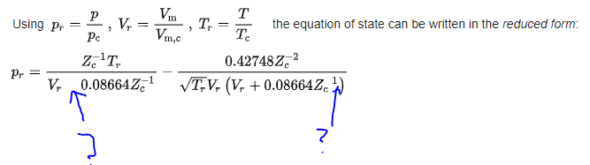

What's a "reduce form" ? Sorry I don't know. Btw https://en.wikipedia.org/wiki/Redlich–Kwong_equation_of_state
you just need the formula in that article. You have to find ##a## and ##b## for the particular substance you are studying. You could get those from any good engineering /chemical engineering handbook. It's been a while since I last check one of those so I can't help you much further.

I saw wikipedia page, but the equation not clear. I think some sign is missing.
from wikipedia:
