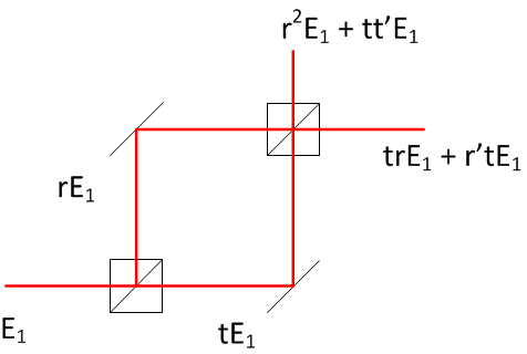

I am reading through my course guide and problems worked out and something bothers me.
I think at this point we are working with classical waves, moving towards QM eventually.
The idealization we work with is this. We have a light source creating a wave [itex] ψ(x,t)=Acos(ωt+kx)[/itex] .
The light beam hits a beam splitter/partially reflective mirror. Half the intensity is reflected, half the intensity is transmitted. Say we do this 3 times to get 4 beams.
As [itex]I = A^2[/itex] , so the amplitude of these waves is A/2 and we get four waves of [tex] ψ(x,t)=\frac{A}{2}cos(ωt+kx+Φ) [/tex]
Now, for combining waves, one is supposed to be able to add them. If the Φ term is made exactly the same, they should be completely identical. One should get [tex] ψ(x,t)=4(\frac{A}{2}cos(ωt+kx+Φ)) [/tex] .
So now we have 2 times the original intensity. This is asymmetrical and something must be wrong somewhere. I don't know if this mixes different idealizations, say QM light as a photon phenomena and classical EM waves phenomena.
Is it somehow impossible to get 100% constructive interference after adding these waves? I know QM light isn't described by a simple sinusoidal wave. I always thought the issue of getting 4 times the intensity with interference is that you get 0 intensity at other spots, so energy is conserved. But there are no plane waves or spherical waves here.
The solution to some problems given clearly show that it adds two beams of 1/4th intensity to get a beam with equal intensity and amplitude to the original beam.
Shouldn't waves be recombined the same was as they are split? So either half the intensity and double the intensity, OR, half the amplitude and double the amplitude.
And how would you combine the four beams so they end up on the same axis ? Ah, with beam splitters!

For the simpler case of one splitter a beam E1 into rE1 and tE1 and a recombination in a second beam splitter, one beam would have (r2 + tt')E1 and the other (rt + tr')E1.
As shown in the link, the standard (ideal, theoretical) 50-50 beam splitter has $$ \begin{pmatrix} t' & r \\ r' & t \end {pmatrix} = {1\over \sqrt 2} \begin{pmatrix} 1& j\\ j& 1 \end {pmatrix}
$$ leading to beam one having amplitude 0 E1 and beam 2 having amplitude ## {1\over 2} (2j)## E1

The link taught (*) me what r, t, r' and t' are and why one of the outgoing beams has amplitude 0 (for proper optical paths)
(the reflections from the simple mirrors and the optical paths are equal for both routes, so they introduce a common (complex) factor with norm 1)

I re-read posts and your post #4 is now easily adressed:
No, a mirror simply has r = 1, t = 0 and we don't care about the r'and t', they can be taken to be 0. No cheating trick (and room for a phase jump as well: no problems as long as |r| remains 1.
Key to this whole treatment is western michigan link eqn 4 through 9. Intensity conservation is pretty high in the pecking order, and the treatment makes sure it is. Same with probability conservation in QM (barring absorption, transitions etc; we are still talking ideal splitters/mirrors). So you can rest assured the analogue treatment in the rochester link is realistic. I like their (15) where you see that non-equal paths introduce a relative phase difference ##\phi## and the waves come out as described above for ##\phi = 0## and out of the other one for ##\phi = \pi##. For all ##\phi## you have that ##\sum E^2## is conserved. As it should be.
