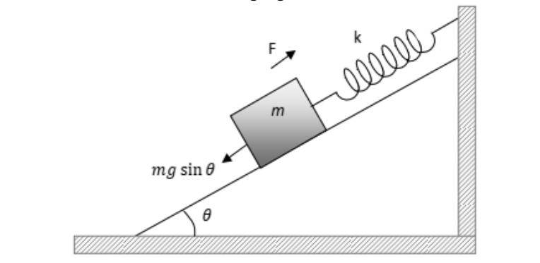

A block of mass 0.2 kg which slides without friction on a θ = 30° incline is connected to the top of the incline by a mass-less spring of relaxed length of 23.75 cm and spring constant 80 N/m as shown in the following figure.
(a) How far from the top of the incline does the block stop?
(b) If the block is pulled slightly down the incline and released, what is the period of the ensuing oscillations? [g = 10ms-2 ].
Can anyone help me in solving this ?
What have you done so far about it? I think (a) is somehow strangely formulated. I would rephrase the question as
(a) At which location does the block stay at rest?

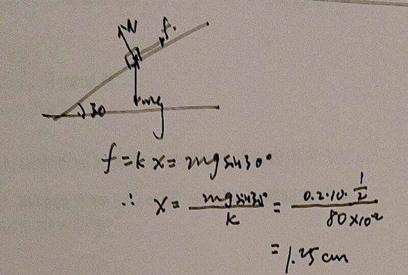

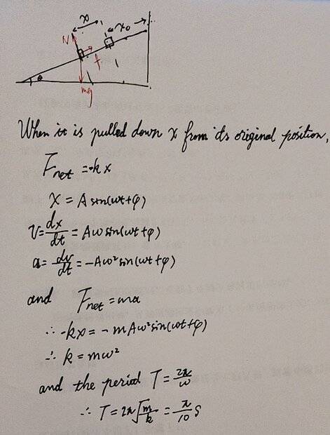

It's 25cm away from the top of the incline.
The thread is two years old, which makes posting a full solution ok.
Unfortunately the question is not quite clear. You have found the equilibrium position, but it asks for where the block will "stop". So possibly we are supposed to assume it is released with the spring at its relaxed length and are to find where it first comes to a stop.
I think that it is more likely that in part (a) we are to assume that the mass comes to and remains at rest. That's because of part (b) which states that "if the block is pulled slightly down the incline and released, what is the period of the ensuing oscillations?" It is easier to pull the mass "slightly down the incline" when it is at rest than when it is moving. Also, if the mass were moving already in part (a), part (b) would just ask for the period of oscillations without needing to mention the initial displacement. That said, I agree that the question is not quite clear.
