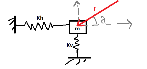

Two linear springs with stiffness Kh, Kv are attached to a single mass m at right angle to each other, i.e; one of the spring(Kh) is in the horizontal direction(x-axis) and the other(Kv) is in the vertical direction(y-axis).
A constant force F is being applied to the mass, inclined at an angle theta with the x-axis.
I need to find the angle which the springs Kh, Kv will subtend with the x-axis and y-axis respectively at the postion of static equilibrium.
F = K * x
I attempted the problem by assuming that the horizontal component of F will just compress the Kh spring by some distance, say a , while the Kv spring will not have any effect as the force is perpendicular to the linear spring. Did the similar thing for vertical component of F.
My query is, is it correct to assume that the horizontal component of F will not have any effect on Kv, as from geometry we can see that if the spring Kh moves by distance a, then the spring Kv will elongate.
Try making several drawings showing possible outcomes.
Is there more info in the question? A drawing perhaps?
Initial condition at the instant of application of force
Now draw it displaced to a likely position.

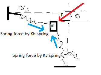

@CWatters : This is how it would look at the equilibrium positions, with the springs forces developed, i wish to know those two angles, aplha1 and aplha2
So can you see how both springs have h and v components.
@CWatters : Yes i can see that, and i have used lami's theorem to obtain some sets of equations. But these equations which I've obtained are very complicated and obtaining the angles aplha1,aplha2 in terms of F & theta is not possible.
Two possibilities..
Post your equations and we'll see if someone from the maths section can help solve them.
or
If one or more of the spring constants are large compared to the applied force then one or more of the angles α1 and α2 might be small enough that you can make a small angle approximation eg Sin(α1) ≈ 0.
What information is known/provided in the problem?
This looks like a good problem to attach via the Principle of Virtual Work. I have not solved the problem, but I think I would probably choose x and y displacements as my generalized coordinates, and then express everything (including the angles) in terms of those two variables.
