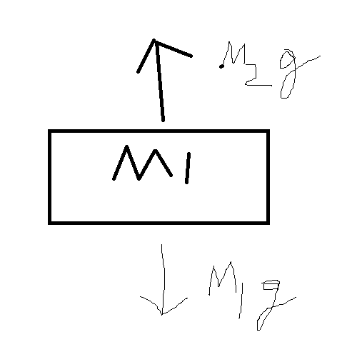

tension in both strings connected is (m1-m2)g. :(
Suyash Singh said:
View attachment 224049 tension in both strings connected is (m1-m2)g. :(
for second body diagram(m2) we replace all 1 with 2 and vice versa
Why are you stating that the upward force on m1 is m2g?
because the other mass is pulling it up
So, is there no difference between this problem and another, in which there is no spring at all, but a single string going from m1 to m2 over the two pulleys?
ummm i don't know.We never have practicals.
supposing the spring balance canceled out the m1g force.
tension = m1g ( for string connected to m1)
Well, it is a simpler problem than the one you started. If you like, you can draw the diagram for that problem, and you will see the point that I am trying to make. That is, we cannot jump to conclusions from every formula that we have on hand. In your situation, you drew the force diagram for only one object. What about the force diagram for the spring?

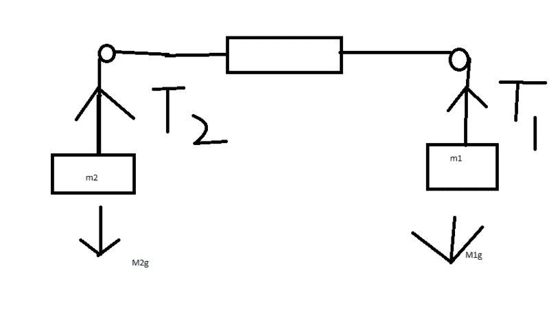

You do not know that yet. Just assign unknowns to the two string tensions, and do not assume the system is static.
Post at least one standard physics equation which you believe may be relevant.
Consider the three bodies separately, and apply that equation to each.
T2=m2g
T1=m1g
spring balance strings have no tension because they are perpendicular
Suyash Singh said:
T2=m2g
T1=m1g
No. For the third time, do not assume the system is static.
Strings have this clever trick of carrying tension around corners and over pulleys.
Likes Suyash Singh

The spring balance we are told is massless, and we can assume that its reading is constant. So its only functions in the question are to connect the two strings and to measure the tension in them. So apart from the measurement you can ignore the balance and treat the two strings as one.
Let the tension in that one string be T. Write two motion equations, one for each mass.
Likes Suyash Singh

ok let acceleration of system be a(downwards of m1)
T=M2(g+a)+m1(g-a)
T=m2g+m2a+m1g-m1a

standard equation:
Force= mass x acceleration
Tension = force
Applying on m2
force=m2(g+a)
Applying on m1
force=m1(g-a)
where net acceleration is in the downward direction of m1 since m1>m2
now i am confused with tension.

Suyash Singh said:
Applying on m2
force=m2(g+a)
Applying on m1
force=m1(g-a)
Right. You have two equations and two unknowns. Solve to find the force.
How does that force relate to what the spring balance shows?
Likes Suyash Singh

a=(m1-m2)g/m1+m2
force=2m1m2/m1+m2
oh so the spring balance shows 2m1m2/m1+m2 since it divides the tension produced by g to get the mass

Suyash Singh said:
force=2m1m2/m1+m2
You missed out g and you should use parentheses in the denominator, but other than that, yes.
