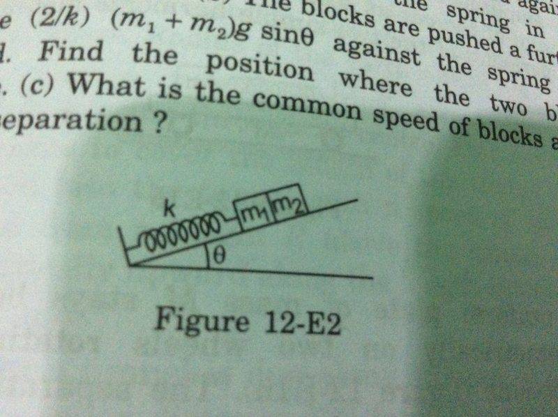

1. Homework Statement :
The block of mass m1 as shown in the figure (pic attached)is fastened to the spring and the block of mass m2 is placed against it.
a)Find the compression of the spring in equilibrium position.
b)The blocks are pushed a further distance (2/k)(m1 + m2)g sinθ
against the spring and released. Find the position where the two blocks seperate.
: [/B]
F=kx (Hookes law)
:[/B]
a)For the time being...we are replacing the two blocks with a block of equivalent mass(M)
i.e M = m1 + m2.
At equilibrium, net force on this new block = 0.
MgSinθ= kx
⇒x=MgSinθ/k = (m1 + m2)gSinθ/k
b) The blocks separate when normal force between them is zero. So m2gSinθ stops acting on m1
Let the stretch in the spring be y at this instant.
So,
At this instant, on m2, no N is acting.
So,
m2a=m2gSinθ
⇒a=gSinθ
⇒Fs/(m1+m2)=gSinθ
⇒ky = (m1+m2)gSinθ
⇒y=(m1+m2)gSinθ/k
so, the spring should by stretch by (m1+m2)gSinθ/k
Why is the answer given "when the spring attains its normal length"...? where am I going wrong?

You wrote the following equation:
randomgamernerd said:
⇒a=gSinθ
This one made sense to me. It is the acceleration of block m2 at the instant the two blocks separate. The reason you came up with that is because you said:
"The blocks separate when normal force between them is zero." I agree with that.
And then your next equation was:
⇒Fs/(m1+m2)=gSinθ
So this equation substituted Fs/(m1 + m2) for a. So now you are basing the acceleration on Fs acting upon both masses. Why would you do that if you know the blocks are separated?
Basically what you found is how far the spring has to be compressed to produce a force that would give 2 blocks the same acceleration as one block would have if it was sliding freely on the ramp.
Here is the main point I was trying to get you to see:
Up until separation, blocks m1 and m2 have the exact same acceleration. When separation occurs, the only force acting on block m2 along the ramp is its weight component in that direction. Thus its acceleration is mgsinθ - like you found. The only reason m1 could have a greater acceleration in the down-the-ramp direction is if it had another force, in addition to its own weight component, acting in that direction. What additional force could possibly show up that would begin to pull m1 down the ramp, resulting in a greater down-the-ramp acceleration than m2 has? I'll give you a hint. It is something that is attached to m1 that, up until this separation time, was pushing it rather than pulling it.
I hope that helps.

The additional force that shows up is the pull force due to the spring.
So forces on m1 are m1gSinθ and spring force...
So if we assume acceleration of m1 to be a, then
m1a = m1gSinθ + kx
what is a equal to here??
Is it that common acceleration??
And what is the use of the other information("if the blocks are pushed a further distance (2/k)...")?
Yes. And I would say that the separation occurs just as the spring passes the zero-force point and just begins to pull. Or mathematically, it occurs when both blocks have acceleration mgsinθ. That is the point where the force of the spring is 0. For a particular spring, its zero-force point is ALWAYS at its normal, unloaded length.
I haven't verified it, but I'm fairly certain that the purpose of that information is to ensure that the spring gets compressed far enough for the 2 blocks to separate. If you imagine the 2 blocks resting on the spring in equilibrium and then you apply a gentle pressure compressing the spring slightly and releasing, the blocks would oscillate back and forth with a very small amplitude. It would not be enough spring compression that, when released, would cause the 2 blocks to separate. If you applied a very large pressure to compress the spring a large amount and then released, that would result in a much larger spring force - enough so that the blocks would separate.
m1a = m1gSinθ + kx
What about the corresponding equation for the other mass? At the point where they separate, what will be the relationship between the two accelerations?
(This problem is much simpler than it appears.)
Agreed. The solution is almost trivial, but not immediately obvious that it is almost trivial.
TomHart said:
I have been there and fully remember the frustration. No problem.
okay..now I got it...thanks for the help...:smile:
That will also be a?? Then it becomes m2a=m2gSinθ
So we have two equations:
m1a = m1gSinθ + kx ...equation A
m2a=m2gSinθ...equation B
From these two I get:
m1m2gSinθ=m1m2gSinθ + m2kx
⇒x=0
Oh! I got it..:woot:
Likes TomHart
⇒x=0
Great.
As TomHart noted in post #11, the information about the extra compression is to ensure that the spring has enough stored energy that the masses reach the point where the spring is relaxed. Otherwise, it could simply have said "assuming the masses later separate..."
