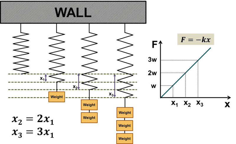

What is the spring constant?
The spring constant, denoted as 'k', is a measure of a spring's stiffness. It is defined as the force required to compress or extend the spring by a unit distance. Mathematically, it is expressed in Newtons per meter (N/m). A higher spring constant indicates a stiffer spring that requires more force to deform it.
How do you calculate the force exerted by a spring?
The force exerted by a spring can be calculated using Hooke's Law, which states that the force (F) is directly proportional to the displacement (x) from its equilibrium position. The formula is F = -kx, where 'k' is the spring constant and 'x' is the displacement. The negative sign indicates that the force exerted by the spring is in the opposite direction of the displacement.
