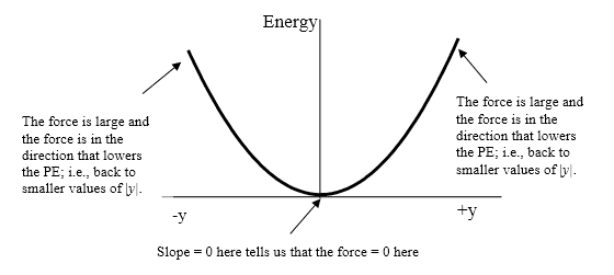

Sorry, Can you please explain why the forces should have same magnitude and opposite direction? I've read somewhere that at equilibrium point(which is the lowest point) the net force that acts on the object is not zero.
However I dont see the related picture so maybe I misunderstood the problem.
I think the problem is not clearly worded, but maybe not since an image was not attached. There is a difference if the mass is hung from the spring and slowly lowered to its at rest equilibrium position, as opposed to being hung from the spring and quickly released. I believe the problem assumes the first case, where the net force on the mass is zero as kuruman has pointed out. In the second case, when the spring extends its full extent, its velocity is momentarily zero, but it is accelerating upward, so the net force is not zero in that case.
Likes MatinSAR, PeroK and erobz
An object is at equilibrium when the sum of all the forces acting on it is zero. You probably confused the lowest point of the potential energy function (i.e. its minimum) with the lowest position of the mass. Study the figure below. It shows the potential energy function for the harmonic oscillator. The equilibrium point is at y = 0. To the left of it is the lowest position marked by the arrow.
Likes MatinSAR
So I was thinking about 2nd case which is not happening in this problem. Thank you.
