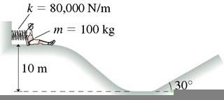

The spring shown in the figure is compressed 50 cm and used to launch a 100 kg physics student. The track is frictionless until it starts up the incline. The student's coefficient of kinetic friction on the 30 degrees incline is 0.15.
Part a : Whats the students speed after leaving the spring?
Part b : How far up the incline does the student go
V = square root ( k * x^2 / m) : 14.1 m/s (answer to part a)
Conservation of energy
I was able to calculate part a and came to an answer of 14.1 m/s. For part b, i solved for the equation of : S = (1/2mV^2 + mgY) / mk*mg*cos(theta) = 155 m. That just seems to large of a distance to travel up an incline. Any ideas?

You have the basic concept correct, just a couple minor flaws in it.
-the v in your 1/2mv^2 is the speed at the bottom of the hill, which is different from the speed at the top of the hill, make sure you readjust that with potential energy.
-W'friction=Mk*FN. I'm assuming Mk is the coefficient of friction? Should probably use [tex]\mu[/tex]. But also the FN is not simply mg! Because the student is going up the incline, remember to readjust FN according to the actual force perpendicular to the slope. (Hint: use a trig function)
Using those should get you the appropriate h, and then s.
Ok, after reading/messing with your hints, and thinking some more, this is the equation i came up with :
S (Hypothenuse) = (1/2mv^2 - Mk*mg*cos(theta)) / (mg*sin(theta)) = 20 meters
Seems logical. Now, the velocity in (1/2mv^2) should still be the 14.1 m/s i found in part a because the speed at the bottom of the hill on a frictionless surface should remain constant, right?

The last part here is incorrect, the speed at the bottom of the hill will not be the same speed at the top of the hill. At the top of the hill, the student possesses kinetic energy from the spring and potential energy from being at the top of the hill. At the bottom of the hill, are there any potential energy left? Where did the potential energy go? :]
That being said, once you adjust the velocity at the bottom of the hill, you should get the correct answer. The equation you gave seems to be correct.
I understand your point, but what's confusing me is at the bottom of the hill, our height is unknown (assuming mgh = 0). Therefore, if i use the conservation of energy = 1/2mv^2 = mgh, I am going to get 0 which can't be correct for v.
Energy Initial = Energy Final
1/2mv^2 + mgh = 1/2mv^2 + 0 ?
Because you don't know the height at the bottom of the hill, it would be wise to set h=0 at the bottom at the hill, so you would get mgh=0, exactly what you have. I'm not really sure where your confusion is coming from, so I'm just going to take a wild stab here and tell you that the 2 v's are not the same. Meaning the energy conservation equation would look like this:
1/2m(v1)^2 + mgh = 1/2m(v2)^2
where v1 is the 14.1 and the v2 is the speed at the bottom of the hill. On the LHS h is 10 and on the RHS there is no mgh since we let h=0 at that point. Notice the mass just cancels out nicely.

From the construction of your equation, you're saying the initial energy is only kinetic, therefore the v here should have been v2. That's the fundamental mistake in your first attempt, you assumed the v here is v1, but if you used v1, you're not including the gravitational potential energy that should have been there. To take this one step further, you also have:
Where h here is the first hill, so 10, m=100kg, and v1 is readily available from your answer to part a. Do you see a nice substitution here that can bypass the need to find v2?

I believe 40m should be he correct answer. If the textbook answer is 20, then I would assume the question is simply asking about the height the student goes up rather than the actual hypotenuse distance.
Otherwise I don't think I'm missing anything from the problem. And I understand, fatigue is the worst. You can literally wake up in the morning and solve a problem you were stuck on for 2 hours last night in 10 mins, I think everyone gets moments like that.
Edit: Yes, the fatigue is definitely affecting you. v2 should be bigger than v1, it would make sense the student is faster at the bottom of the hill than on top. Yet your v2 is less than v1. My calculation gives me 19.9m/s for v2, so it seems like you missed a 10 there. Also, it would help if you share the answer in the textbook so we can look at what might have went wrong.
Unfortunately, I don't have the textbook answer because this is an even numbered problem (11.56). I have one more attempt on the problem, i might as well put 20 to see what happens :) . I really appreciate your help throughout both problems tonight and God Bless ya!
EDIT: With my last attempt, i put 20 meters and according to mastering physics, that too is incorrect. I will email my instructor tonight to see if maybe Mastering Physics is incorrect or find out where i went wrong.
Thanks again!
I managed to get this one right (and all I'll say is that it is between 20 and 40 m !). I had the kinetic energy at the bottom of the hill divided by m*g*sin(theta)+(Mu of k)*m*g*cos(theta). What really saved me was the substitution of the height with the distance*sin(theta), which was suggested above.
