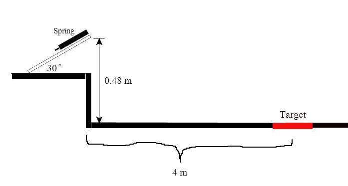

In my physics 12 class, we were given a spring and had to launch it at an angle into a target (the object launched is the spring itself). The target was on the floor level but the spring was launched from above the floor level. I need to find out how far to pull the spring back so it will travel to the target.
I also have to find out how to calculate the maximum height of the spring.
Mass of spring = 0.04012kg
k = 26 N/m (it was measured before )
Height of launch from the ground: 0.48 m
The horizontal distance from the target to the spring: 4 m
It is clearly related to the elastic potential of the spring and kinetic energy as well.

I don't think you have provided enough information for your kind helpers to make that choice, so it's up to you.
Next issue: the required accuracy. If your drawing is to scale, the target distance is (4 ##\pm## 0.4) m. So you can check if that can distinguish between a correct calculation (yours) or an incorrect one (the website expression you used, which, as haru made clear in post #18, isn't really appropriate). Perhaps you've just been lucky :cool: !

For the last thing that you mentioned, yeah i think i got lucky because the difference between the answers that the equations give are not that much and probably one of my friends stretched it a bit more just to account for the energy loss at the time of the experiment :biggrin:
Now for ur point, the top end of the spring was at 0.48 m when not stretched. And i personally don't think it makes a considerable difference ( Do you think it does?) but it was a very good point that you mentioned. Thanks for all of your responses ! I really appreciate it :smile:
