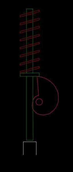

I am thinking an mechanism a bit like a windshield wiper motor could work coupled with a 'trip' mechanism... the motor stops at top dead center, as soon as it moves past, it releases the spring (Perhaps a cam?) and the spring does the work to drive the staple, the motor continues to turn and then catches the spring and brings it back to top dead center and stops, waiting for the next cycle

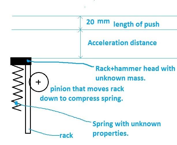

The most simple way to do it would be to just have a big DC motor+ gear transmission to power a rack with a continuous force of 400 N, and a movement speed of about 20 mm/s, to meet the speed requirement. Yes, it would be overpowered for all of the stroke, except for the spike at the end, but it would be safeguarded against unforeseen conditions, such as stapling into a weird material. When the push sequence is complete, the pinion that drives the rack could disconnect from the rack, allowing a weak spring to push it down immediately. The problem is that this require a rather expensive and heavy motor.
What I'd like to understand better, is what would be required if the stapling was done by a hammer head accelerated by a powerful spring. At the end of the cycle, the spring is compressed by a rack, actuated by a pinion which is connected to a smaller, less expensive motor.
Why do I expect the spring+mass to afford me to get a smaller motor? Because although it is important that the push happens quickly, it's perfectly fine is it takes some time to prepare for the next cycle, i.e. the smaller motor can do it's job over a longer period of time, thus having a lower power output. If the motor is directly powering the stapling, then it has to churn out all of that energy in the push phase.
This is my question: How do I pick a spring and mass (or rather: mass and impact velocity) that I know will be able to do the stapling? I'm not sure if I trust the idea that I just have to give the mass the same kinetic energy as the work that is required for the stapling.
If your motor is disconnected (or at least not braking) during the hammering process, apart from the staple and the spring there is nothing else that would take up energy (neglecting the inelastic collision between hammer and staple) until everything stops at the end of the fully pushed staples.

I assumed the hammer has significantly more mass than the staples (otherwise the collision will cost some energy), and ignored alignment issues.

Here's my idea, using a windshield wiper motor as the drive with a cam... Not fancy drafting work, but you get the idea
