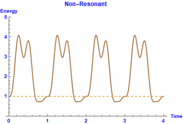

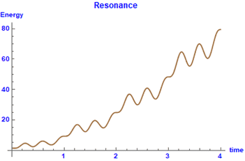

This seems OK to me. The system is an undamped, driven harmonic oscillator. If you consider the solution when ##w_1=w## (i.e., resonance), the energy will continue to build up over time. The graph below shows this for a particular choice of parameters such that the natural frequency of the oscillator is f = 1 Hz and it is driven at 1 Hz.
If the same oscillator is driven at 2 Hz, then the energy varies with time as
You can see that the energy returns to its initial value after each unit of time (i.e., each multiple of the natural period of the oscillator). This turns out to be true for any driving frequency that is an integer multiple of the natural frequency (other than resonance). Since you averaged ##\alpha '## over one period, it is maybe not surprising that you get zero for this average when n is a positive integer different from 1.

TSny said:
In the above equations, ##\beta## would have units of time rather than a phase angle. Maybe you meant to move ##w## inside the parentheses.
The coefficients of the trig functions on the right sides don't appear to have the correct dimensions if ##\alpha## is energy and ##\beta## is an angle.This seems OK to me. The system is an undamped, driven harmonic oscillator. If you consider the solution when ##w_1=w## (i.e., resonance), the energy will continue to build up over time. The graph below shows this for a particular choice of parameters such that the natural frequency of the oscillator is f = 2πω = 1 Hz and it is driven at 1 Hz.
https://www.physicsforums.com/attachments/236996If the same oscillator is driven at 2 Hz, then the energy varies with time as
https://www.physicsforums.com/attachments/236997

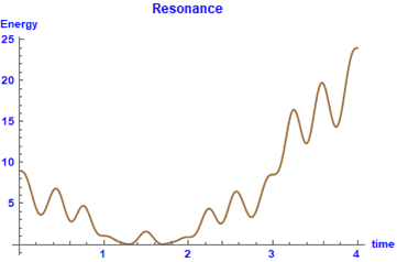

Yes, it is interesting. As long as you are not exactly on resonance, the amplitude of the motion will remain finite. So, the energy in the system remains bounded.
For the case of resonance, for certain initial conditions, the energy of the system can actually decrease at first and then increase without bound as shown below.
[Edit: Figure corrected]
