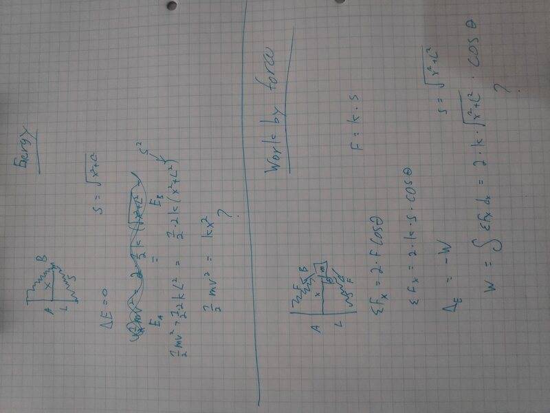

I'm trying to solve this question: A body is released from position (b), what will his speed at position (a)
https://imgur.com/a/Ms7widx
I know i need to use the spring energy formula but not sure how to do it at an angle. Will i have to multiply it by the angle of the spring. Or calculate the difference in length between the two positions?
Thanks :)

I had quite a few attemps my current one is:
The energy at A is equal to the energy at B
At B with have no kenetic energy, and 2 spring energies
at A with have kenetic energy (and no spring energy?)
So 2*0.5kx^2 = 0.5mv^2
But I'm not sure if it is correct use x as the distance between A and B.
Also the spring is at an angle so maybe I need to add the angle someway (cos Ø?)
I'm sure that definitely must be wrong! Neither spring is contracting by ##x##.

Can I add to what @PeroK has said. You are using the same symbol 'x' for two different things.
In your expression “0.5kx^2”, the 'x' means the spring’s extension (its increase in length from its unstretched length). But in your diagram, 'x' means the horizontal distance the mass moves.
Use a different symbol for the spring's extension (e.g. ‘e’). Edit1: Or use 'd'!
Edit2: no don't use 'd', as the question already uses 'd' for the initial extension.

I think that the opposition of forces doesn't "lose" energy and still keeps the conservation of energy.
I thought about analysing forces but the problem I came across is that i will need to do inegral on an equation with theta (which is kinda difficult I think)

Did you sort it out? If not (as I suspect from your attachment) try answering these...
Q1. The initial extension of each spring is d, so the initial energy stored in each spring is ____.
Q2. When m is displaced a distance x to the right, the new length of each spring, in terms of x and θ, is _______ (hint: use a bit of simple trigonometry).
Q3. Using the answer to Q2, the new extension of each spring is ___________.
Q4. Using the answer to Q3, the new energy stored in each spring is now _____________
Q5. So when m was displaced a distance x to thee right (and using your answers to Q1 and Q4) each spring was given additional energy _____________.
If you can answer those, the rest of the problem should be plain sailing.
