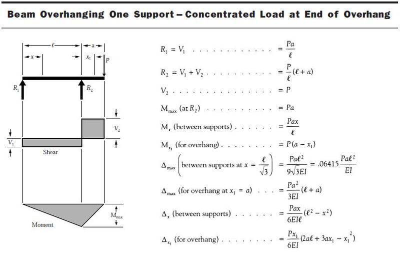

I'm a diving coach at the local YMCA and I want to give a lesson regarding the physics of diving off the board with maximum efficiency. This is the type of diving board with an adjustable fulcrum, basically a lever with one end fixed with bolts. Its been almost 15 years since I've taken a physics course. I've been able to refresh my knowledge of the torque at various point of the board (at the fixed end, at the free end, at the fulcrum) and according to my analysis, when the fulcrum is positioned at the midpoint of the diving board the torque on the fulcrum is maximized.
Practical experience tells me that the position of the fulcrum changes the stiffness of the board, i.e. how much force the board pushes against the weight + downward force of a jumping diver to return the board to equilibrium position. My instinct tells me Hooke's law can be applied to model this, but I'm not too sure how to apply it because as the position of the fulcrum is changed, the "spring constant" is not constant but variable. The stiffness of the board also affects the force necessary to displace the free end of the diving board, i.e. the diver needs more force with a stiffer board (fulcrum closer to free end) to achieve a displacement of equal value vs the force applied to a less stiff board (fulcrum closer to fixed end.

The theory you need to look at is the Euler-Bernoulli beam theory.
I found your case already solved in this figure (although the end is not bolted, but free to pivot):
Your diver exerting a force ##P## at the end of the board will create a deflection ##\Delta_{max}## on the board. Therefore, the equivalent stiffness ##k## for the board is:
$$k = \frac{P}{\Delta_{max}} = \frac{3EI}{a^2 (l+a)}$$
##E## is the Young's modulus of the material for the board;
##I## is the second moment of area of the board, which represents the geometry of the cross-section of the board.
If you go to the extreme case of a cantilever beam, the equation is:
$$k = \frac{F}{\Delta_{max}} = \frac{3EI}{L^3}$$
The amount of energy ##E## stored in the board - which will be returned to push the diver back up - is:
$$E= \frac{1}{2}kx^2= \frac{1}{2}k\left(\frac{F}{k}\right)^2= \frac{F^2}{2k}$$
So for the cantilever beam:
$$E = \frac{F^2}{6EI}L^3$$
And for the beam with a fulcrum:
$$E = \frac{F^2}{6EI}a^2 (l+a)$$
So a cantilever beam will offer the maximum returned energy for a given force ##F## applied to it (assuming ##l+a = L##). That is because it offers the maximum deflection possible. For the first case, the further the fulcrum is from the force (##l \rightarrow 0##), the more deflection you get (i.e. the more your board looks like a full cantilever beam).

I agree with the beam calculations. I did it the long way by integrating ##\int \frac{M^2}{2EI}dx## same results for this single applied load. (however, ignoring shear strain energy for this wide/shallow beam could be an error), but I'm not sure of its "overall factor" in setting up the dive?
