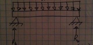

In summary: Ok, well basically...I'm trying to determine what spring to use to ensure the tarp remains tight, even during snow fall.There are three arches supporting the tarp and all four ends are attached to springs. The north/south ends (20' length side) are attached in an arch shape and the east/west ends (60' length sides) are attached vertically to the base and the tarp.The tarp weights 750 lbs and is 60 ft by 20 ft.There are 20 springs attached to the end plates (north and south) and 60 springs on the base (east and west).Snow can accumulate at a value of 25 lb/ft^2.The equation to solve
Steven2012
The distance from the spring attachment to the arch in 9 feet.
The distance from the arch to the arch is 20 feet.
There are three arches. So, End plate-spring to arch to arch to arch to spring-end plate.
What are all the forces and the parameters needed to define the springs (K, X1, and X2).
F=mg
F=K(X1-X2)
F=32.2(750)=24150
Modeling just from the arch to the spring as a single string/rope->
24150/60=402.5 lb/ft
Spring is Ra and arch is Rb, F is mg of tarp
Ra+Rb=F
402.5*9/2=1811.25 = Ra=Rb
So, 1811.25=K(X1-X2)
This just seems bad wrong
I really want to find out what my K value should be and I want the spring to be about 8 inches.

Can anyone figure out the relationship between the problem statement and the figure? If not, I'm going to delete this thread.

The image is my attempt to model the problem as a beam (which I now think is a bad idea). The image shows the uniform force, Ra, and Rb.

I still don't understand the problem statement. Maybe it's just me.
Does that help?
I can draw the design I have right now- if that would help.
A good diagram would be very helpful. I'm still unable to picture it.
