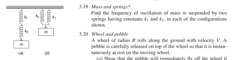

Find the frequency of oscillation of mass m suspended by two
springs having constants k1 and k2, in each of the configurations
shown.
x = A sinωt + B cosωt

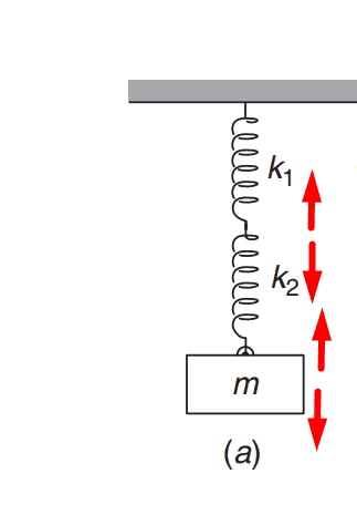

I found the answer for the springs in parallel, but not for the ones in series. I believe I don't understand how the forces are interacting properly.
Here's a force diagram I drew. Everytime I try to make equations from this though my answer dosen't make sense. The mass m has a gravititoanl force applied to it, and spring 2 applies a restoring force to mass m. On spring 1, the mass m applies a gravitational force, and spring 2 applies a restoring force onto spring 1 towards itself. Spring 1 applies a restoring force towards itself.
I think there's something wrong with this interpretation, but I don't understand what.

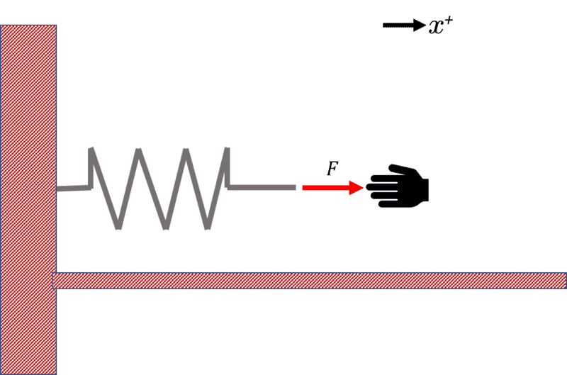

If there is one spring and you applied a force ##F## you would expect deflection ##\Delta y##. If you use a second identical spring to apply the force ##F## to the first spring what deflection would you expect?
Delta y?
flinnbella said:
Delta y?
Think about the force applied to the second spring, what force is the second spring applying to the first spring?
It is applying k_2*delta_y to the first spring
While it may be true, I’m think it’s missing the point. ##F## is applied to the second spring. What is force is applied to the first? You can think of this like two ropes if you like. If you apply ##F## to the second rope, what is the tension developed in each rope?
If it was two ropes, the force would be F? If the ropes are in equilibrium then T = F, so the force from rope 2 to rope 1 is F?
Correct. ##F## is applied to both ropes. Now, put the springs back. Each spring is acting under applied load ##F##. Meaning the total deflection the end of the second spring sees relative to the origin is ( assuming identical springs)?

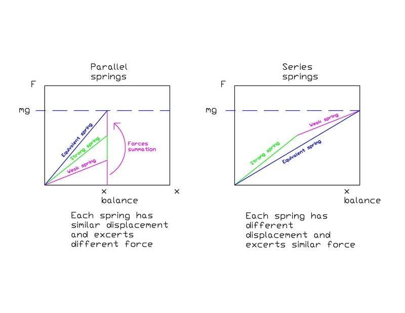

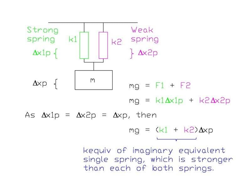

With the parallel setup, the displacement is the same for each spring - thus also the same for an equivalent spring replacing both - but the forces from each spring are added together to be applied to the equivalent spring. So:
$$\Delta y_1 = \Delta y_2 = \Delta y_{eq}$$
$$F_1 + F_2 = F_{eq}$$
And, for each spring:
$$F_n = k_n \Delta y_n$$
From these, you found the value of ##k_{eq}## in terms of ##k_1## and ##k_2##. These are basically 6 equations with 6 unknowns, namely: ##F_1,\ F_2,\ k_{eq},\ \Delta y_1,\ \Delta y_2## and ##\Delta y_{eq}##. (We also know that ##F_{eq} = mg##)
Find now the same equations that relate the displacements and the forces together when the springs are in series. Which variables are the same and which ones are added together?

Yes, you already did part of the job earlier:
erobz said:
This means:
$$F_1 = F_2 = F_{eq}\ (= mg)$$

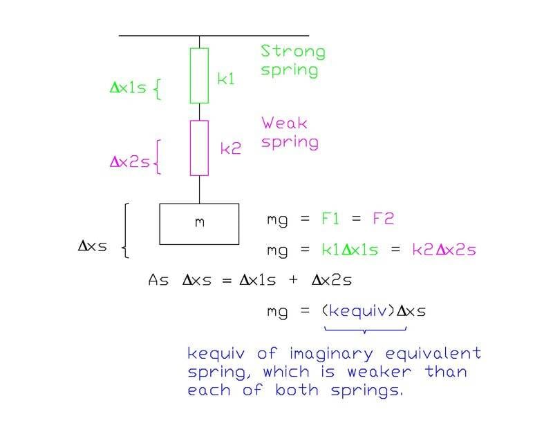

Ok. So the restoring force of each spring is equal. Then what? We don't know the displacement of each spring.
But you do know the deflection of each( edit: in terms of the other), because you know the force applied to each and the spring constants.
What is the relationship between ##\Delta y_1##, ##\Delta y_2## and ##\Delta y_{eq}##?
deltay1 + deltay2 is the total displacement, so deltayeq is the same as their sum
Likes jack action and erobz
Now use the relationship in #19 to relate the equivalent spring to either of the other springs.
Ok, so k_1*delta_x = k_2*delta_y = k_eq*(delta_x + delta_y).

Put those equations (##F_n = k_n\Delta y_n##) in the displacement equation instead.
  • #31
erobz said:
It is a placeholder. We are trying to find the effective spring
Ok I get that the total displacement of the mass is delta_x + delta_y, and this can be represented by a single spring instead of two. However, I don't see a relationship between the spring constants.
  • #32
Just continue on with #26. You are so close. We can talk about what it means as you go.
You have that ##A = B = C##, we want to pick ##A## or ##B## to relate to ##C##. Then you will use ##A## to relate to ##B##. In the end you will find the spring with constant ##k_{eq}##, that behaves as though it were identical to the series springs.
  • #33
I got k_1+k_2/(k_1 + k_2) = k_eq. So I have the forces in terms of k1, k2.
  • #34
I think you messed up the algebra or the application of the equations ( I can't tell because you don't shot the steps you took)
  • #35
This is what you did for the springs in parallel:
$$k_1\Delta y_1 + k_2\Delta y_2 = k_{eq}\Delta y_{eq}$$
And because ##\Delta y_1 = \Delta y_2 = \Delta y_{eq}##:
$$k_1 + k_2 = k_{eq}$$
So what are you going to do with ##\Delta y_1 + \Delta y_2 = \Delta y_{eq}## in our case with springs in series?
