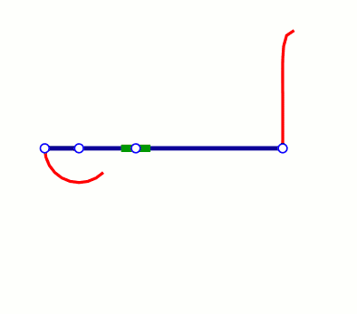

Anyways, to the point, I am very keen on replicating Mythbusters' "Arrow Machinegun"(), which is a very simple mechanism, basically containing two sprockets, one roll chain, some handles, a slider, bow, string, release mechanism and other miscs.
The problem is, how in the bloody universe, do you have two sprockets and a chain to reciprocate? I heard Jamie saying "the sprocket engaging the slider", but how?
I would really like it if you guys can draw me a model of how I can do it. It'd be even more awesome if you can use Algodoo and draw it for me!
Thanks a lot! :D

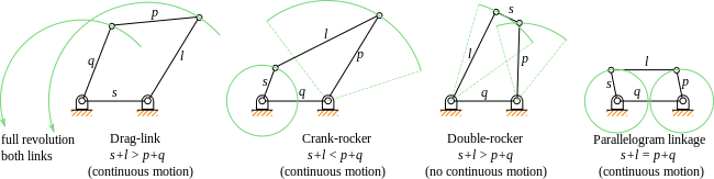

I'm not sure how the presented mechanism work, but you can convert rotational motion into a reciprocating motion with many mechanisms:
The crank and slider:
The Hoeckens linkage:
Any 4-bar linkage of the crank-rocker type:
@jack action
First off, thanks a lot for the reply!
The linkage systems, cranks and basic rotary/linear converters won't work for me, because the mechanism I am using is attached to the roll chain, which consists of both rotary and linear motions, so it won't cut it for me.
HOWEVER, I worked it out with a very simple solution this morning; I fused it with a scotch yoke! I attached it with a red pin on the roll chain, and it works just fine; eureka!
Check out the pictures I attached.
Red: Slotted link mechanism
White: Frictionless sliders
Green: Body
Gray: Roll chain
Yellow: Sprockets (gears, wutevz)
Anyways, thanks a lot for your help! :D
https://flic.kr/p/sm8Sb5
https://flic.kr/p/sogoSW
https://flic.kr/p/sogp2U
I forgot about that one. Good catch, as I couldn't wrap my head around why they use a chain with 2 sprockets of the same size. It makes perfect sense now.
