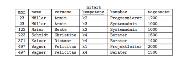

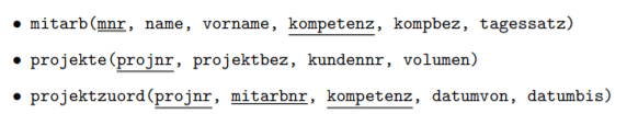

Hey mathmari!
You have matched the employee on the column "mnr", but that is not a primary key is it?
That is, it does not uniquely identify an employee. (Worried)
Furthermore, it "should also be applicable to other data of the same form".
Suppose we want want to use it for "Facilitymanagement" instead of "Lagerreorganisation", then the query won't work, will it? (Worried)
"mnr" is a primary kry for mitarb, it is underlined. :unsure:
This one was also unclear to me. What does this mean that it should be also be applicable to other data of the same form? How can it be general ? :unsure:
There is only one primary key in a table, which is a combination of 1 or more columns. 🧐
In this case the primary key should consist of the combination of mnr and kompetenz.
To be fair, it does look a bit strange that they made kompetenz part of the primary key, but that is what it says.
Consider the table projectzuord. It has projnr underlined, but that is not a primary key on its own is it?
Any projnr will definitely be duplicated in multiple rows as there will usually be more than 1 employee that is assigned to a project. 🤔

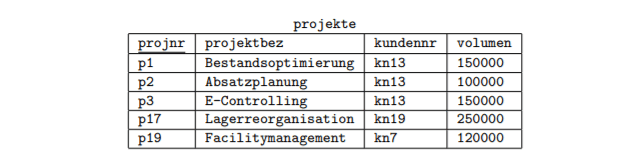

SELECT DISTINCT m.vorname, m.name
FROM mitarb m, projektzuord z, projekte p
WHERE m.mnr = z.mitarbnr AND p.projektbez = (SELECT p.projektbez FROM projekte p WHERE p.projektbez = 'Lagerreorganisation' ) AND p.projnr = z.projnr :unsure:
mathmari said:
So do you mean it as follows ?
Did you check if it works? 🤔
Either way, I think it should be:
WHERE m.mnr = z.mitarbnr AND z.projnr IN (SELECT p.projnr FROM projekte p WHERE p.projektbez = 'Lagerreorganisation' )
That is, we don't need `projekte p` in the FROM clause, and we don't need to refer to it in the WHERE clause either.
I've also changed the "=" into "IN" since the result of the sub query is a set. 🤔Btw, alternatively we can also do:
WHERE m.mnr = z.mitarbnr AND p.projnr = z.projnr AND p.projektbez = 'Lagerreorganisation'
can't we? 🤔

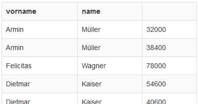

If I run that, then I get:
I see a couple of problems:
1. Armin shows up twice.
2. The 3rd column doesn't have a header.
3. The table doesn't have the employee with the biggest sales at the top.
(Worried)
3. The 3rd column has negative numbers.
(Worried)
I corrected the problems 2 and 3. Do we not solve the first problem with DISTINCT ?
I have now this but I get again Armin several times. :unsure:
Armin can work both as a programmer and as a system administrator and he gets paid different rates for those roles.
I think we have to combine them somehow. 🤔

mathmari said:
Do we do that with GROUP BY ?
Yes. 🤔
Yes. 🤔
Do we not write that as follows ?
SELECT DISTINCT m.vorname, m.name, DATEDIFF(day, z.datumvon, z.datumbis)*m.tagessatz AS Umsatz
WHERE m.mnr = z.mitarbnr AND m.kompetenz = z.kompetenz
GROUP BY m.vorname, m.name Because I get the error :
Column 'projektzuord.datumvon' is invalid in the select list because it is not contained in either an aggregate function or the GROUP BY clause.
:unsure:
We are trying to group the 2 rows that refer to Armin into 1 row.
Those 2 rows have different numbers for the Umsatz.
How should those 2 numbers be combined (aka aggregated)? 🤔

At (3) :
SELECT p.projektbez
FROM projektzuord z, projekte p
GROUP BY p.projektbez, p.projnr
HAVING COUNT(p.projektbez)>=2 AND p.projnr = ANY (SELECT z.projnr FROM projektzuord z)At (4) :
SELECT COUNT(m.mnr), m.kompetenz
FROM projektzuord z, mitarb m
WHERE ((z.datumbis $<$ '20220315' OR z.datumvon $>$ '20220409') AND (m.mnr = z.mitarbnr)) OR m.mnr != ALL (SELECT z.mitarbnr FROM projektzuord z)
GROUP BY m.mnr, m.kompetenzAt (5) do we make INSERT the new values in the corresponding tables?
INSERT INTO projekte
VALUES
('p42', 'Datenreorganisation', 'kn99', 12000);
INSERT INTO projektzuord
VALUES
('p42', 123, 'k3', '2022-03-01', '2022-05-31');
:unsure:
