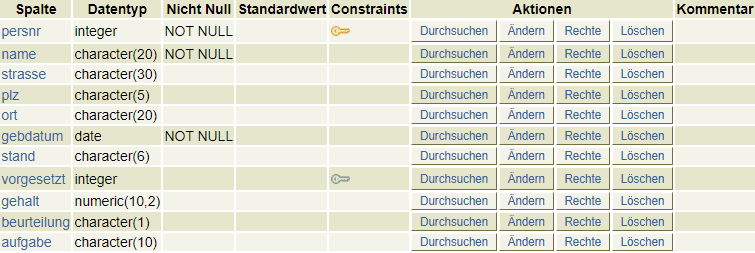

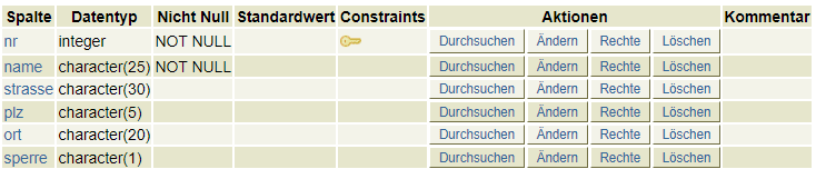

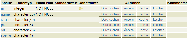

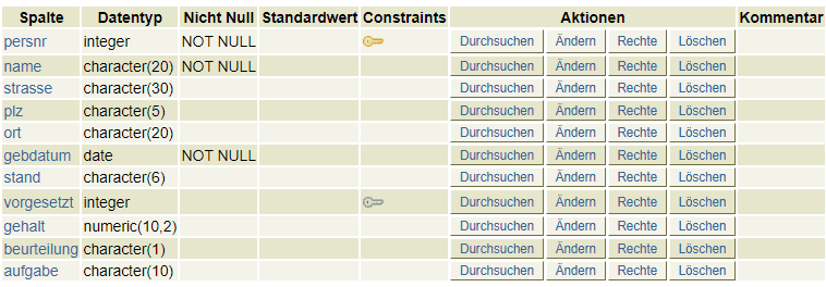

Ahh ok, we have the following :
Then at "personal" we have :
Therefore at expression 1 do we have the following ?
Code:
SELECT *
FROM personal
WHERE name = "Ernst Pach"
Then at 2 do we have the following ?
Code:
SELECT *
FROM personal
WHERE gehalt > "4000" AND ort = "Regensburg"
:unsure:

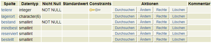

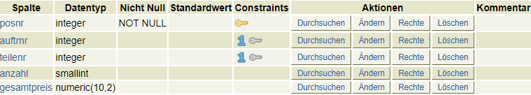

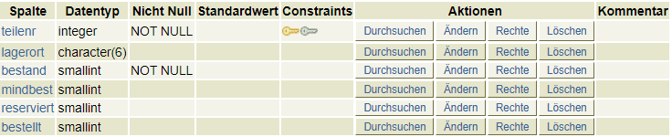

For the expression 3 I think we have touse the table for the warehouse (lager):
Then do we have the following ?
Code:
SELECT *
FROM lager
WHERE betand > "5"
Is that correct? :unsure:

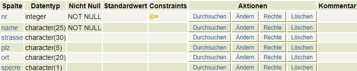

For 4 we use the table for the customer (kunde) :
How can we check if for a customer an order exists ? :unsure:

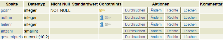

At 5 thee table is :
:unsure:
It looks as if you have access to a database program with the tables.
If so, then perhaps you can also try your SQL queries on it directly?
I think that one of the buttons at the top will likely gives you access to a window where you can type SQL queries. (Wondering)
Code:
SELECT *
FROM personal
If it is a number, then we shouldn't use quotes.
So we should be able to write gehalt > 4000. 🤔
mathmari said:
For the expression 3 I think we have to use the table for the warehouse (lager):
Code:
SELECT *
FROM lager
WHERE betand > "5"
Shouldn't it be >= 5?
And there is a typo.
So it should be bestand >= 5. 🤔

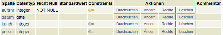

We can do a query on multiple tables.
For instance:
Code:
SELECT *
FROM customers AS k, auftrag AS a
WHERE k.kundnr = a.kundnr;
Looks as if we will need a query with a function in it. 🤔

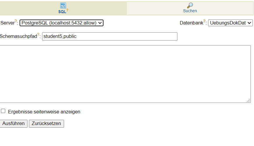

Where can I type the SQL queries? Do you have an idea?
:unsure:

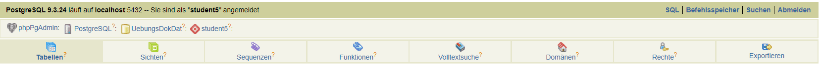

I see "SQL" at the top right in the caption bar, which looks like something we might be able to click on. 🤔
Alternatively Sichten, Sequenzen, and Funktionen are candidates. 🤔
I see you have PostgreSQL. I found this:
That is, it may be that you have a dedicated SQL Shell (psql) in your windows menu where PostgreSQL is. 🤔
I also see that you have buttons for Durchsuchen and others.
Durchsuchen probably pops up a search dialog, which may support SQL.
It's also possible that we need to click an "Advanced" button or some such to get to SQL in a text window. 🤔
At SQL I get :
So there I will the codes that we wrote above?
For example for 1 I will write there :
SELECT *
FROM personal
right? :unsure:
mathmari said:
At SQL I get :
Yep. (Sun)

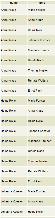

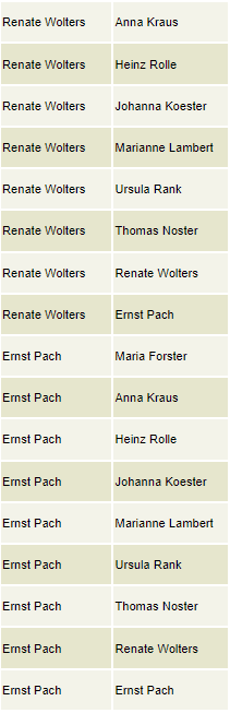

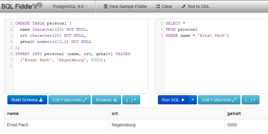

I get :
Have I done something wrong or does it mean that in the table that name is not included? :unsure:
I think that the syntax is somehow wrong.
What do you get if you run just SELECT * FROM personal; ? 🤔
Perhaps we need WHERE name = 'Ernst Pach' with single quotes instead of double quotes. 🤔
It appears that the problem is indeed the quotes, which must be single quotes.
I could get the same problem with http://sqlfiddle.com.
I selected PostgreSQL 9.6 and was able to execute:
At 4 do you mean:
SELECT *
FROM kunde k, auftrag a
WHERE k.kundnr = a.kundnr And k.ort='Regensburg';
Or how do we write that? :unsure:At 5 do we have the following?
SELECT *
FROM auftragsposten a
WHERE a.anzahl<=ALL (select a.anzahl from auftragsposten) OR a.teilenr=100001;Here I get :
mathmari said:
At 4 do you mean:
SELECT *
Looks correct to me. (Nod)

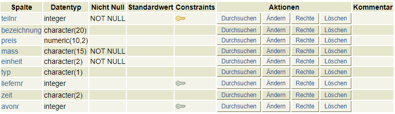

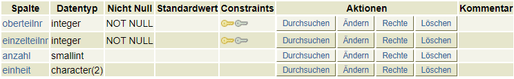

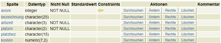

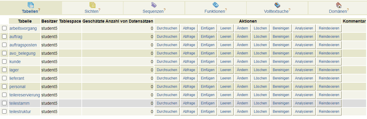

Here are all the given tables :
arbeitsvorgang :
auftrag :
auftragsposten :
avo_belegung :
kunde :
lager :
lieferant :
personal :
teilereservierung :
teilestamm :
teilestruktur :
Do we maybe use any other table from them ? :unsure:

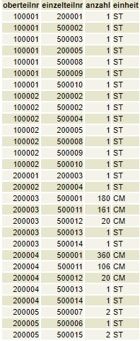

I think you had the correct table, but maybe we need to aggregate it differently.
What do you get for:
SELECT teilenr, SUM(anzahl)
FROM auftragsposten
GROUP BY teilenr;
FROM auftragsposten
GROUP BY teilenr;
Could you explain to me what it does exactly? Why do we take the sum? GROUP BY means that that we consider more than 1 column? :unsure:
It finds the sum of anzahl's for each teilenr, which should correspond to the volume for that teilenr.
GROUP BY means that we group the rows by teilenr and find the sum of anzahl for each group. 🤔

I haven't really understood why wehave to consider the sum and not just the anzahl? Could you explain that further to me? :unsure:
I checked it and it is probably meant the total price ofan order... So we do :
Code:
SELECT *
FROM auftragsposten
WHERE gesamtpreis=(SELECT MIN(gesamtpreis) FROM auftragsposten) OR teilenr=100001;

As for 1 I am confused about which table we should consider. Could you explain that for me? :unsure:
At 2 we consider the table "personal" and check the field "vorgesetzt" ? :unsure:
  • #32
mathmari said:
1. Give a SQL expression that will find out which employee received the order from Maier Ingrid.
2. Give a SQL expression that lists the names of all employees with the names of their managers. If an employee does not have a manager, it should also be listed.
Looks like we need to consider the kunde table to find the KUNDNR of 'Maier Ingrid'.
Then the autrag table to find orders from that customer.
Then the personal table to find which employee handled the order. 🤔
Yes. I think "vorgesetzt" is a "persnr" in the personal table. :unsure:
So we have :
SELECT p.name
FROM personal p, auftrag a, kunde k
WHERE (p.persnr = a.auftrnr) AND (a.kundnr = k.nr) AND (k.name = 'Maier Ingrid') I get as a result a name... Is that command correct for that what we want to do? :unsure:

  • #35
Perhaps we should call them "employee" and "manager" instead of p1 and p2.
Then we need that "employee.vorgesetzt = manager.persnr". 🤔
Writing the command :
SELECT employee.name, manager.name
FROM personal employee, personal manager
WHERE employee.vorgesetzt = manager.persnr

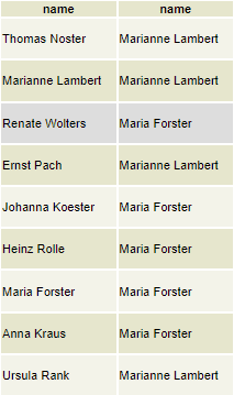

I get :

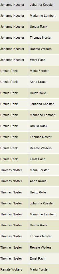

This is only the result that the employee has a manager, right? We have to print also the employees that have no manager, right? Do we write this condition in the below form somehow? :unsure:
WHERE employee.vorgesetzt = manager.persnr OR (employee.vorgesetzt != ALL (SELECT manager.persnr FROM personal)
As it is right now I think I get all possible combinations of employee and manager :
So do we maybe not have to use OR but something else? :unsure:
