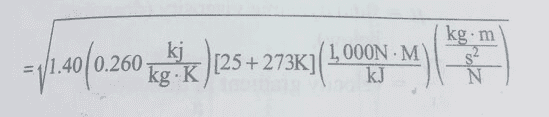

Summary:: Why are you multiplying by 1000NM/kJ within square root?
Practice problem for FE
It's just a units conversion. Multiply by "1" whenever you want to convert from one set of units to another (and have the two sets of units in the numerator and denominator with appropriate multipliers to keep the fraction = 1):
$$1 = \frac{1000 N m}{1kJ}$$
Or in words, "1000 Newton-meters is equal to 1 kiloJoule" :wink:
Likes etotheipi
BTW, they appear to be using both "M" and "m" for meters. Or am I misinterpreting something?
Likes sandmanvgc
Yes, just as they use j and J for joules. Pure carelessness.
Likes berkeman
That threw me off
Likes berkeman
They are all over the place with units. They also have [25 + 273K] as if only the second term has units. Totally bizarre.
