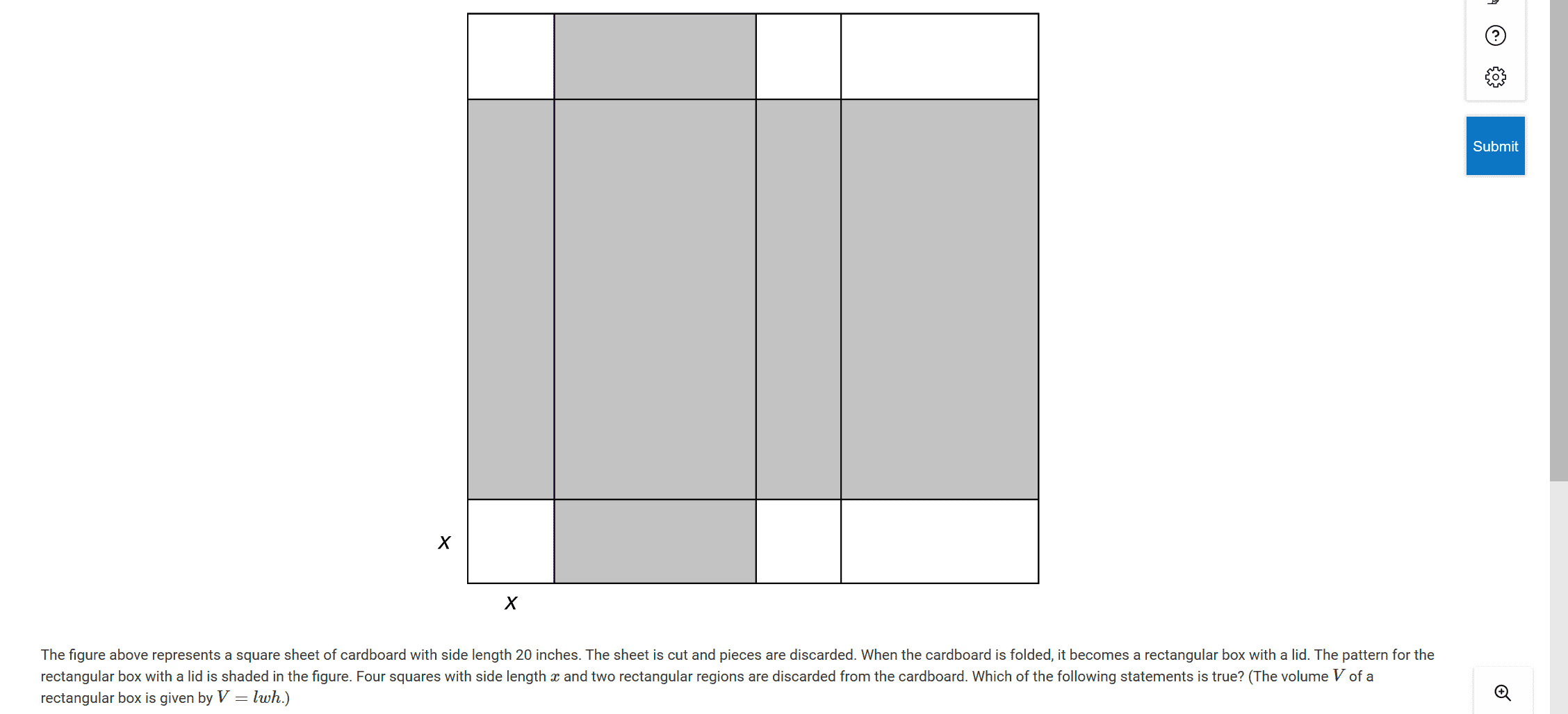

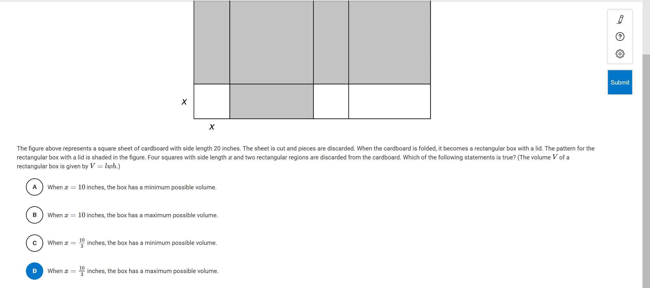

The question and the answer choices are in the screenshots. I need it asap if possible please. Thanks!

$L=20-2x$, $W=10-x$, $H=x$
what now?

$V = LWH$
get an equation for the box volume in terms of x, determine the value of x that makes V’ = 0, then use the first or second derivative test to determine if that value of x indicates a max or min volume.
The equation in terms of x would be V = 2x^3 - 40x^2 + 200x

More importantly, is it possible to make a box if x = 10?
It would not be possible for x = 10 inches because once it is substituted into the original equation it gives a result of 0
- - - Updated - - -
So the only x value that we are left with is 10/3
How do I identify if there is a maximum or a minimum with x = 10/3?
So, does x = 10/3 determine a max or a min volume?
x = 10/3 would give off a maximum volume right?
