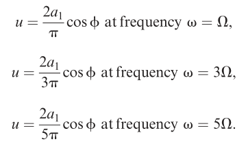

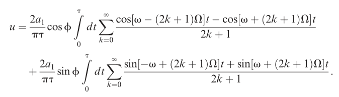

Here is my problem:
this is the equation at the LPF of the LIA, when multiplying a sine wave and a square wave, setting
the equation reduces to
after integration we get
which means

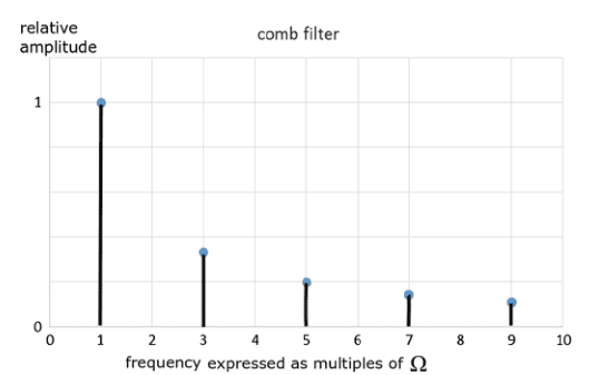

which means for an impure sinewave with harmonics or some noise at harmonics will get demodulated, but not to the fundamental frequency, this results in the combed filter effect as shown by
My question is when mutliplying two sqaure wave why does the analog devices website show that everything gets demodulated to fundamental DC? When the surae wave itself is composed of infinte sine waves I would expect multiplication of two sqaure waves to also give demodulated output at non zero frequencies.

Yes, exactly. The mixer does that too.
But a lock-in amplifier has a low pass filter that (ideally) rejects everything that isn't DC. If you put two frequencies ##f_1## and ##f_2## into a balanced mixer, the output is at ##f_1 + f_2## and at ##f_1 - f_2##. Then you reject anything that isn't DC, so we only care about the signals where ##f_1 = f_2##.
If there are multiple frequencies in the inputs then each one mixes with the others. So if you mix frequencies ##f_1 + 3f_1## with ##f_2 + 3f_2##, you get mixer outputs at all of the combinations ##f_1 + f_2##, ##f_1 - f_2##, ##f_1 + 3f_2##, ##f_1 - 3f_2##, ##3f_1 + f_2##, ##3f_1 - f_2##, ##3f_1 + 3f_2##, ##3f_1 - 3f_2##, etc. The ones that subtract to 0 (DC), get through the LPF.

Thanks a lot, I finally understand T_T
