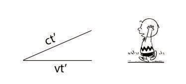

However, on a different train, the passenger sets up the light clock differently.
And the observer sees things somewhat differently.
And so he gets a different equation.Yet a third passenger sets things up differently again.
And now the observer sees something yet different and is totally thrown for a loop

We are still dealing with inertial frames so which is the 'correct' model? Obviously, the first depiction is always portrayed so there must be an explanation supporting its validity over the others.
I think the main point here is that an observer cannot measure the time it takes for light to travel from one location to another. They can only measure how long it takes light to travel to a location, and then back again. When the light makes a round trip, the two ratios become the same.

As others mentioned, none of those is a proper light clock without the return back to the same place in the frame where it is measuring time.
That said, the perpendicular light clock avoids the complication of length contraction. For any other orientation you must also include length contraction. If you do so then you will find that all orientations are consistent. The perpendicular orientation is used for simplicity.

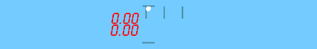

Light clock example with arms both perpendicular and parallel to the relative motion.
As already noted the observer stationary with respect to the animation frame, measures a length contraction of the parallel arm.
Once this is accounted for, the math give the same time dilation( for a round trip) no matter what angle the light is aimed for the light clock.
Aside: I find looking at that animation fascinating. Watching the light pulse in the moving horizontal light clock, the pulse looks to return much faster than its outward leg. I know its speed should always be the same and the time difference is from the movement of the mirrors. I trust Janus to do that right, and I know the clock numbers are there for me to check if I want. But it looks fast. I think I intuitively do a Galilean transform into the frame of the mirrors (wildly inappropriate for a system moving at 0.87c).

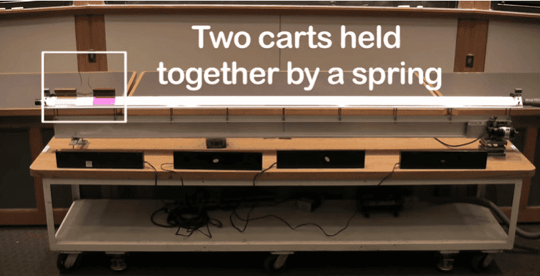

Watch the Frame of Reference video (Ivey & Hume, 1960) from time stamp 10:00 ...
Not quite the same... but the Push Me Pull You setup displays some interesting motions, in the presence of possible visual distractions.
[ www.youtube.com/watch?v=amfw2nABke4 ]
