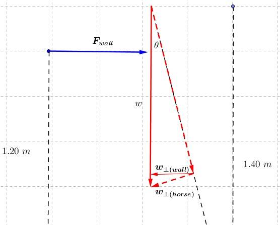

It seems this problem is intended to be one where torque applies, but I don't see it in that way. And of course my answer doesn't agree with that given by the textbook :).
The diagram:
According to my understanding, there is a component of the weight acting along the horse's body (the diagonal I've drawn) and another one perpendicular to its body, which is making it rotate to the left. I labeled the latter ##w_{\perp(horse)}##. The component of ##w_{\perp(horse)}## that lies perpendicular to the wall, I think, has the same magnitude that the force exerted by the wall on the horse. This is what I mean:
Then:
##w_{\perp(horse)} = w\sin(\theta)##
##F_{wall} = w_{\perp(horse)}\cos(\theta)##
##F_{wall} = w\sin(\theta)\cos(\theta)##
And by Newton's Third Law, this is the force exerted on the wall.
The angle is found to be ##14.04º##, so
##F_{wall} = 500\ kg \cdot 9.80\ m/s^2 \cdot \sin(14.04º) \cdot \cos(14.04º) = 1.15 \times 10^3 N##
Maybe it should have a negative sign since it's in the opposite direction, but that is not what I'm worried about. The textbook's answer is ##1.43 \times 10^3 N##. I have no idea what I'm missing /:.
Thanks !

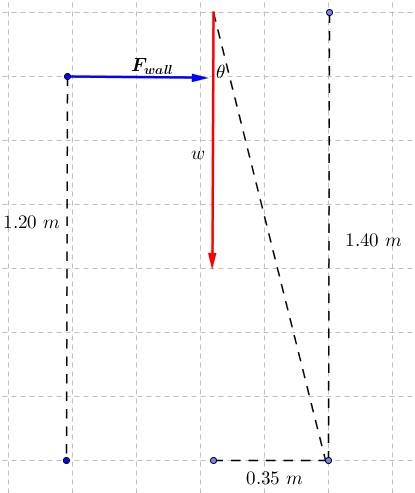

You are over complicating this problem and getting messed up. Sum torques about the horses feet. Torque of a force is force times perpendicular distance.
Ah, I see. I confused the perpendicular distance with the perpendicular component of the force (I've been doing so all the time :) ).
##\sum \tau = 0 = \tau_{ccw} - \tau_{cw}##
##\sum \tau = 0 = \tau_{weight} - \tau_{wall}##
##\tau_{wall} = \tau_{weight}##
##F_{wall} = \frac{500\ kg \cdot 9.80\ m/s^2 \cdot 0.35\ m}{1.20\ m}##
##F_{wall} = 1.43 \times 10^3\ N##
If I were to solve a similar problem where ##\sum F = 0##, I must then assume ##F_{wall} = friction ## and ##w = F_{normal}## about the horses feet, right? I want to be sure about it, because I also got confused with that and with the fact that the forces are acting along different heights/distances.
Yes, that is correct. Normal force from ground acts up on the horses feet equal in magnitude to its weight, and the ground friction force on its feet acts left , equal in magnitude to the normal wall force.
Nice!
Thanks for helping me [:
