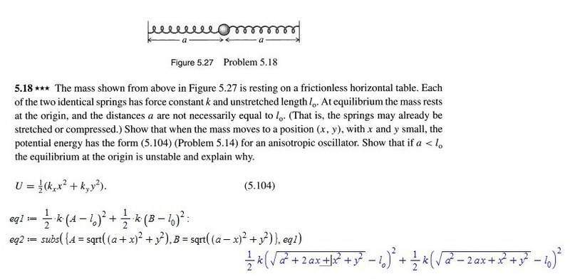

Attached
5.104 mentioned in the problem is
Also attached
Suppose the mass is moved to (x,y), the distance from the mass to the left spring is denoted by A, the distance from the mass to the right spring is denoted by B. I get the expression in the last line.
If I expand the whole expression, and treat sqrt((a+/-x)^2+y^2) as simply a (for small x and y, << a), I can obtain the potential energy in the form of 5.104 after eliminating certain constants, however, that doesn't help me in solving the eqm part of the question.
Differentiating the expression with respect to x doesn't give a solution when the first derivative = 0, which would then indicate that there's no minimum point. I'm stuck. Please help!
Then I would like to see how you obtain the simplified expression for U :smile:
My result is: [tex]U = k(a-l_o)^2 + k(1-\frac{l_o}{a})x^2 + k(1-\frac{l_o}{a})y^2[/tex]
Why does [tex]\partial U/\partial x = 0[/tex] not give any solution?

Can you show me how you arrive at the expression for U? I've tried to derive U from force consideration, the resulting expression looks way too complicated. The expression obtained by merely adding the potential energy from both springs is still too complicated as well.
Thanks for your help :)
From your exact expression of U:
[tex] U = \frac{1}{2}k(\sqrt{a^2+2ax+x^2+y^2}-l_o)^2 + \frac{1}{2}k(\sqrt{a^2-2ax+x^2+y^2}-l_o)^2[/tex]
We have:
[tex] U = k(a^2+x^2+y^2+l_o^2-2l_o(\sqrt{a^2+2ax+x^2+y^2}+\sqrt{a^2-2ax+x^2+y^2}))[/tex]
Notice that:
[tex]\sqrt{a^2+2ax+x^2+y^2} \approx a(1+\frac{x}{a}+\frac{x^2}{2a^2}+\frac{y^2}{2a^2})[/tex]
[tex]\sqrt{a^2-2ax+x^2+y^2} \approx a(1-\frac{x}{a}+\frac{x^2}{2a^2}+\frac{y^2}{2a^2})[/tex]
(due to [tex]a\sqrt{1+\epsilon} \approx a(1 + \frac{\epsilon}{2})[/tex] )
And we arrive at the result.
