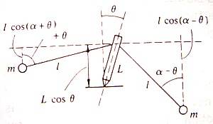

In the image above, the toy consists of two identical mass hanging from a peg. we take the zero potential energy at the pivot.
:[/B]
http://www.physicsmynd.com/?p=1172
Since the potential energy is zero at the pivot, and the potential energy is defined by U(θ)=mgh, I had:
U(θ)= mg(- l*cos(α+θ)- l*cos(α-θ))
but the solution is: U(θ)= mg(L*cos(θ) - l*cos(α+θ)) +mg(L*cos(θ) - l*cos(α-θ))
So my question is,what is wrong with my answer, and why?

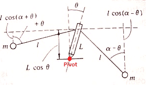

The zero of PE is at the pivot point.
l*cos(α-θ) is not the vertical distance between the pivot point and the mass on the right.

Thank you very much sir, I think my problem was with English more than it was with physics, I thought what he meant be pivot is the joining point of the arms with the peg, now I got the solution right.
