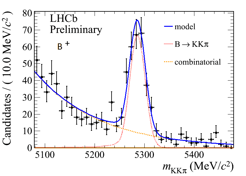

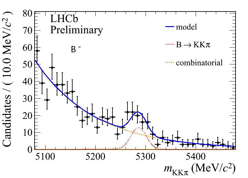

CP violation with charged mesons has been observed by LHCb, and it is massive in the channel considered. Here are two plots from the LHCb website, CP conservation would mean both peaks have the same height:
Thanks for the update. It is a pity that this result wasn't more widely publicized, but I suppose it is hard to make a mass media story after an important empirical confirmation of a key aspect of the SM when the vast majority of people don't know that it hadn't been confirmed in the first place.
