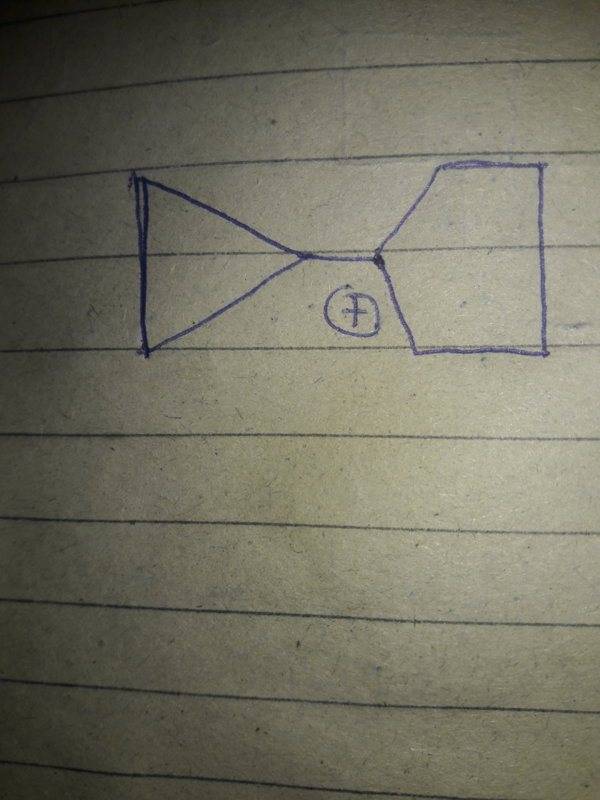

Is cyclopropyl cyclopentane carbocation also exceptionally stable or not?Give reason for you answer.

Here is an image of the structure
I know that cyclopropyl methyl carbocation is exceptionally stable due to an effect so called dancing resonance which takes place because of lot of strain in cyclopropyl ring and vacant p orbital of Carbon attached with the ring.
So I think this is a similar situation as vacant p orbital of carbon which has positive charge attached with cyclopropyl ring has its vacant p orbital perpendicular to bonding orbital.So dancing resonance can take place here.So it should also be exceptionally stable.I don't know the answer.Am I correct?

I think you’re probably right. I haven’t looked at the cyclopropyl cyclopentane cation specifically (i.e., there may be a weird rearrangement that I’m missing), but most substituted methylcyclopropyl cations are anomalously stable because of sigma resonance (cyclopropane C-C bonds donating into the empty p-orbital on the methyl cation). I don’t immediately see why this particular one would be different.

Poked around a little more and found a few references to that molecule specifically:
Review article by Olah, et al.
Original article cited by above
It behaves as expected (enhanced stability, bisected geometry, etc).
Edit: the cyclobutyl/cyclopropyl cation, on the other hand, is apparently a big mess.

Thanks for that article.But I didn't understood why cyclobutyl/cyclopropyl cation is a mess.
