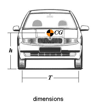

From http://hpwizard.com/car-performance.html" :
Rollover limit
Because the friction force acts at ground level and the inertia force acts at the center of gravity, there will be a weight transfer from the inside tires to the outside tires. Once the vertical force acting on the inside tires is equal to 0, then the inside tires are off the ground, leaving the total weight of the vehicle on the outside tires. This is the rollover limit. The maximum load that can be transferred from the inside tires will be half of the total vertical force.
The maximum lateral acceleration is:
[tex]a_{L_{max}} = 0.5 \frac{T}{h}[/tex]
aLmax=0.5Th
With regards to the inertia force, is it same as inertial/centrifugal force in a non-inertial frame? If that's the case, I don't understand how the friction/centripetal force can co-exist with the inertia force when viewed from a specific frame of reference?
If the forklift isn't changing speed or direction, then the line of application of the weight is vertical.
If the forklift has acceleration a forward, then from the point of view of the driver (ie in his non-inertial frame of reference), there is an extra "fictitious gravity" …
this is horizontal, equal to a backward.
If the forklift is turning with a turning circle of radius r at speed v, again there is an extra "fictitious gravity" …
this is horizontal, equal to v2/r sideways and outward.
(multiply it by m, and you have the centrifugal force mv2/r)
To find the line of application of the weight, you simply add all the gravity together, ie g down, a backward, and v2/r sideways …
if that line falls outside the stability triangle, the forklift tips. :smile:
(and, for a particular speed or turn, as you raise the CG, the angle of the line stays the same, but since it now starts higher, it gets closer to the edge of the stability triangle)
(btw, "inertial" means proportional to the mass, so both real gravity and "fictitious gravity" produce inertial forces)
